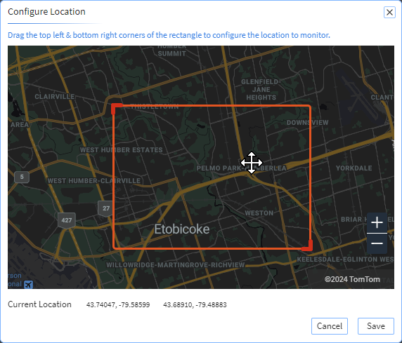

- In the Filter section, select the Add Filter icon and
then choose one of the following filter types:

Location In the Configure Location panel, drag the top left and bottom right corners of the red rectangle to configure the location to monitor. Move and resize the red rectangle to select a specific area on the map.

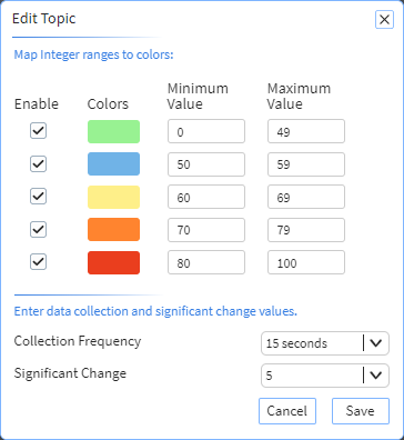

You can edit the properties of the circles by highlighting a topic on the Selected list and then selecting Edit.
The Edit Topic panel displays.
You can assign meaning to each color by defining a range during which the color displays. For example, the topic could represent the number of pallets of bottled water in a delivery truck.
Assume that this topic is at the top of the list, represented on the map by the inner marble. The marble shows green when the truck has between 80 and 100 cases of water. When the stock drops to 70 cases, the marble turns blue. If the stock drops below 24 cases, the marble turns red.
Use the Collection Frequency dropdown list to set how often the device sends topic data. Select a value from the Significant Change dropdown to choose an amount of change that must happen before the device sends data. This prevents transmission of every small change, thereby saving unnecessary data usage. You can configure this setting so that expected fluctuation does not generate data. In the example, if the truck's stock of bottled water drops by five cases between collection frequencies, the device sends data.
