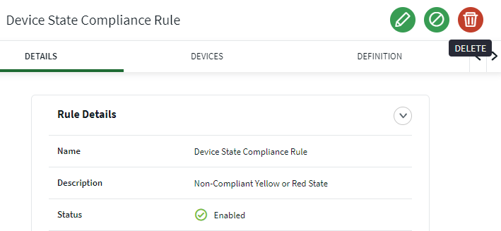

  2. Select the compliance policy you want to delete.
  3. In the pop-up panel, select the Delete icon.

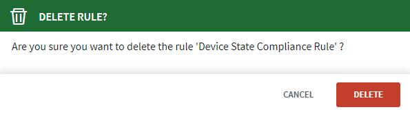

  4. In the Delete Rule? confirmation panel, select Delete to permanently remove the compliance policy.
You have deleted the selected compliance policy.
