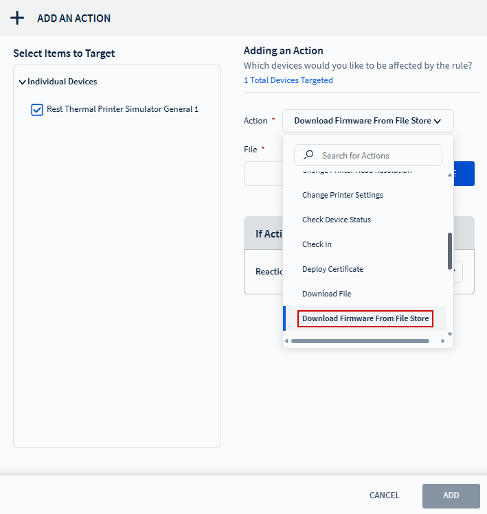

  6. In the Setup panel, under the Action(s) section, select the button. The Add an Action dialog box opens.
    Adding an Action
  7. From the Action list, select Download Firmware From File Store.
    Note: Depending on the device and file type, the action may appear as Download File From File Store, Download Firmware From File Store, or a similar option.
  8. Choose Select File, then locate the file you want to push to the device.
  9. Select Add. The Add an Action dialog box closes, and the selected file and content type appear in the Action(s) section of the Setup panel.
