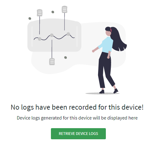

If no device logs appear in the tab, select Retrieve Device
Logs in the main screen:

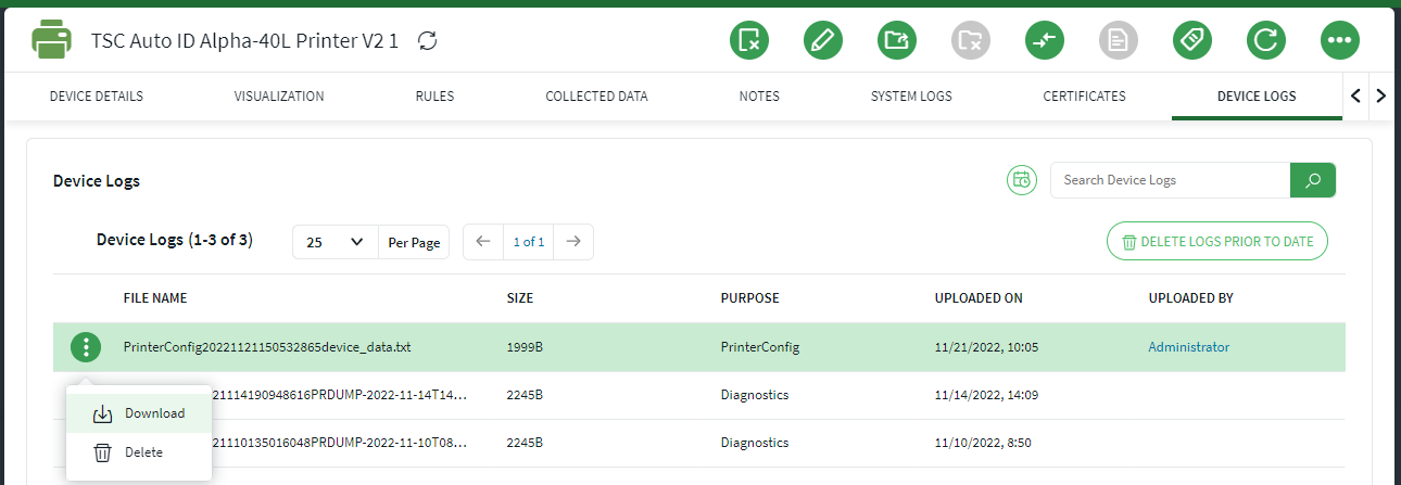

When the logs appear in the tab, select the More button
beside the device log you want to download and select
Download:
