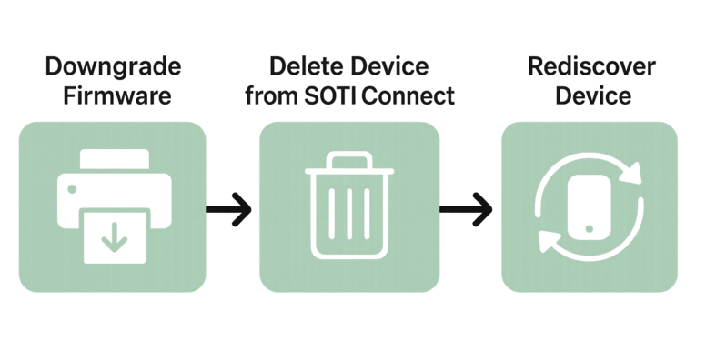

Downgrading Firmware
Follow these steps in the exact order to complete the downgrade successfully:
  1. Downgrade the device firmware to the required version.
    Tip: Use the File Store view to push the older firmware. See Pushing a File to a Device for details.
  2. Delete the device from SOTI Connect. See Deleting a Device for details.
  3. Rediscover the device. See Discovering Devices for details.
The device is re-enrolled in SOTI Connect with the correct properties and actions that match the downgraded firmware version.
