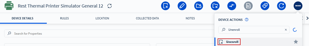

  4. On the device action bar, or in the device information panel, select Unenroll. A confirmation dialog box appears.
    Unenrolling a device

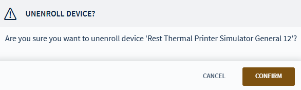

  5. In the confirmation dialog box, select Confirm.
    Confirming device unenrollment
The device is now unenrolled from SOTI Connect. You can re-add it at any time by going to the New Devices section of the Alerts view and selecting the Rejected Devices tab and selecting Approve.
