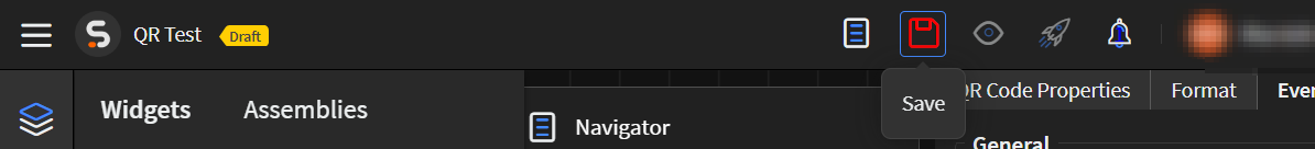

- Select Save in the SOTI Snap banner to apply your
changes.
Tip: Select Preview to see how the widget appears in your app.Selecting a specific manufacturer and model You can choose the skin for the manufacturer and model of your device. - From the rightmost panel, select the skin icon. The Skin Selector dialog opens.
