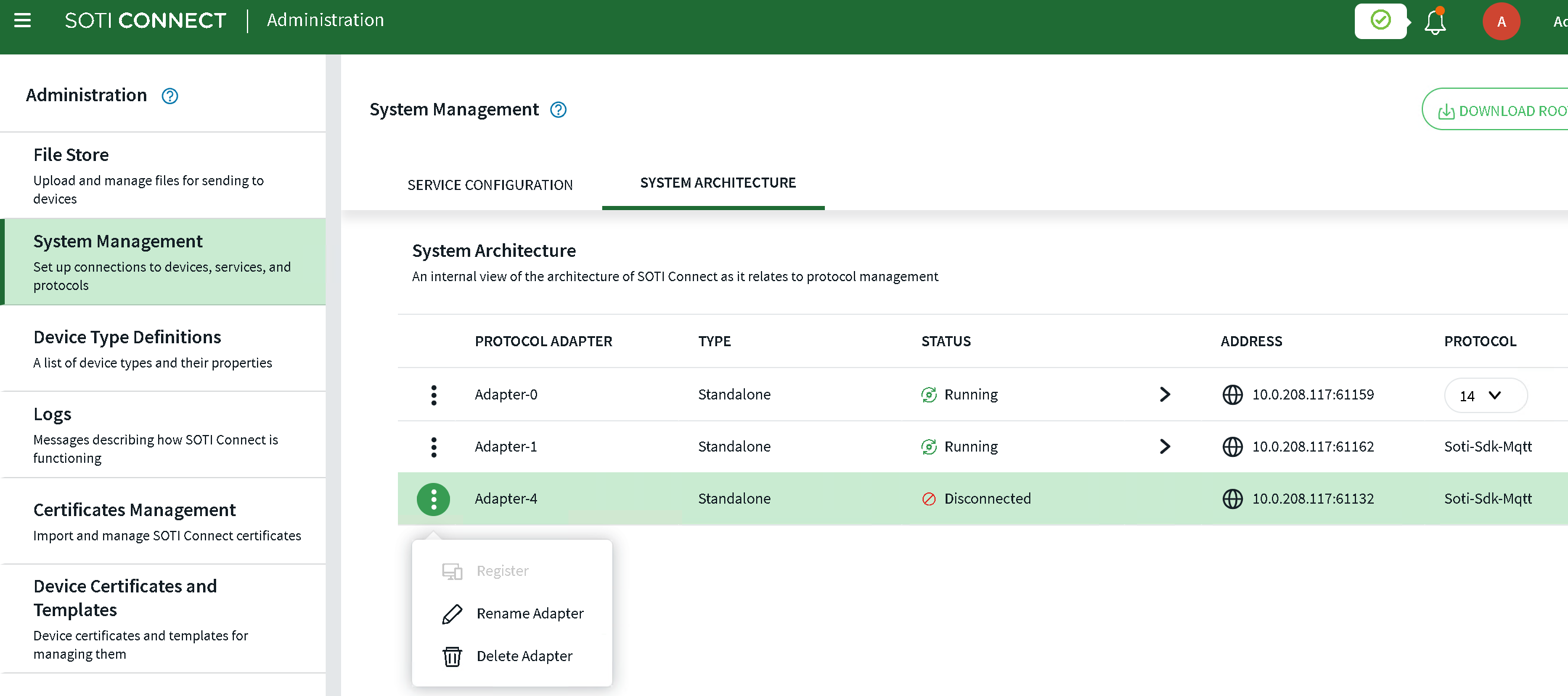

Verify that the new PAs are running on the screen.

Remove any unnecessary PAs.

The connection must be refreshed on the device side. To do that, run Discover
Devices on the Rest PA as shown in the diagram below.
