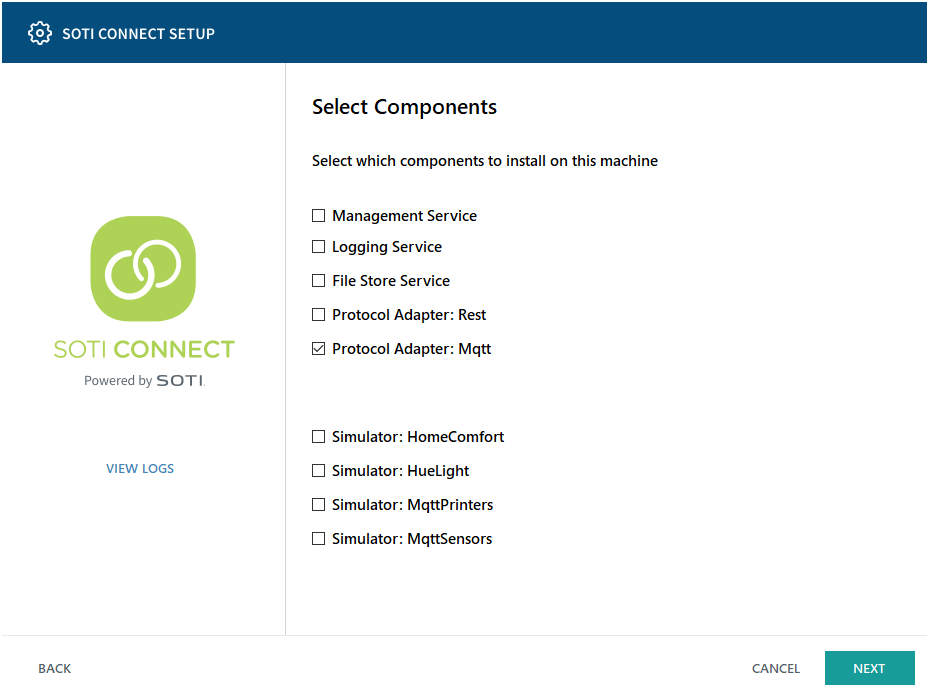

  3. Select Custom, then click Next. The Select Components window is displayed.
    Custom
  4. Select Protocol Adapter: Mqtt or Protocol Adapter: Mqtt RPC, then click Next. The Communication Certificates window is displayed.
    Note: Options for Management Service, Logging Service, and File Store Service should be unchecked. These were installed when the MS was established.
    Setup Wizard Components Screen
