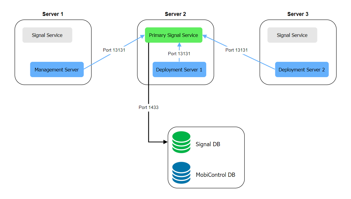

Signal Network Diagram
The following diagram illustrates an example multi-server environment with Signal configured.
Signal network example diagram
