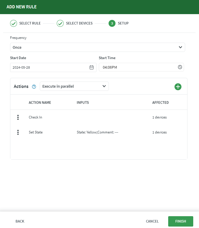

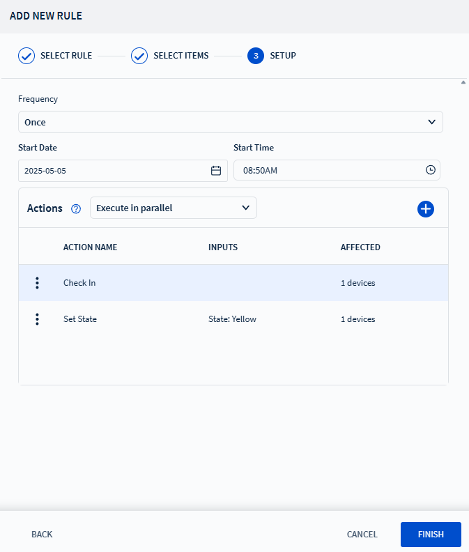

Actions Execute in Parallel
When actions execute in parallel, actions execute simultaneously. This means that you cannot predict which action completes first because both actions are running at the same time. This can be useful in situations where actions are independent and do not rely on each other to complete.
Warning: When using enrollment rules with parallel actions, a device action may execute before the enrollment action. In this case, the action will not be applied to the device. To avoid this issue, use "Execute Sequentially".
For example, the following enrollment rule has two actions: "Check In" and "Set State":
Rules with many actions run in parallel

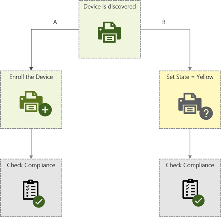

Consider the evaluation of a compliance rule, along with the above enrollment rule that states "when Device State is Yellow, set Compliance Status to Non-compliant."
Unpredictable results occur when many rules evaluate in parallel
The compliance check evaluates unpredictably and either one of the following outcomes can occur:
  • Case 1: If A evaluates after B, the device is compliant.
  • Case 2: If B evaluates after A, the device is non-compliant.

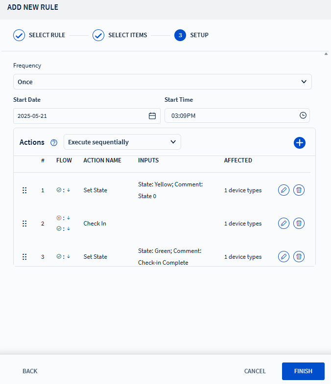

Actions Execute Sequentially
When actions execute sequentially, actions execute one after the other. Each action must complete before the next one can begin. This ensures a predictable order of execution and outcomes, which is beneficial when actions are dependent on the completion of previous actions.
For example, consider this rule, where actions execute one after other:
This rule causes the following actions to execute sequentially:
  1. Set device state to "Yellow."
  2. Begin device check-in. If device check-in fails, interrupt the rule.
  3. If device check-in succeeds, set device state to "Green."
