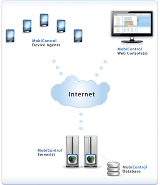

The following image shows a typical installation configuration. The Manager is installed on the workstations of the system administrator or support personnel. The Deployment Server(s) and MobiControl database are installed on one or more servers. The Web Console is installed where the MobiControl Management Service is running, and can be accessed from anywhere using Internet Explorer 8 and above. ![]() MobiControl Architecture MobiControl Manager System RequirementsThe MobiControl Manager is a Windows application, and runs on any
desktop, notebook PC or server that is capable of running
Microsoft Server 2003 or later.

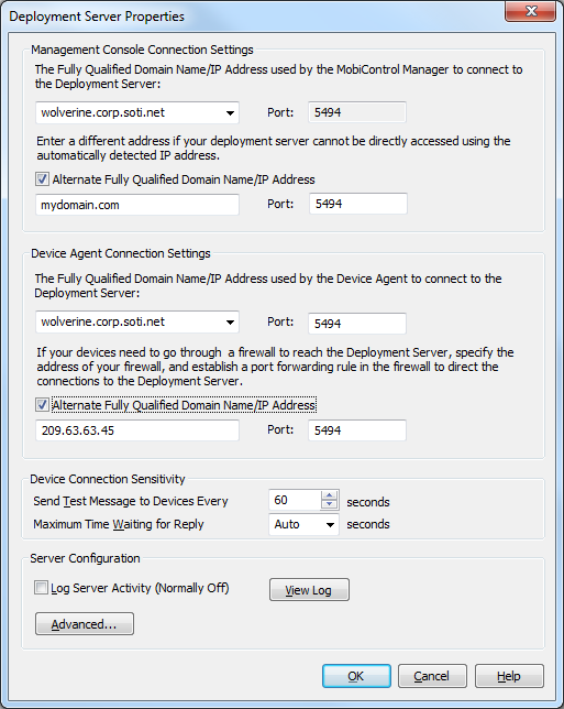

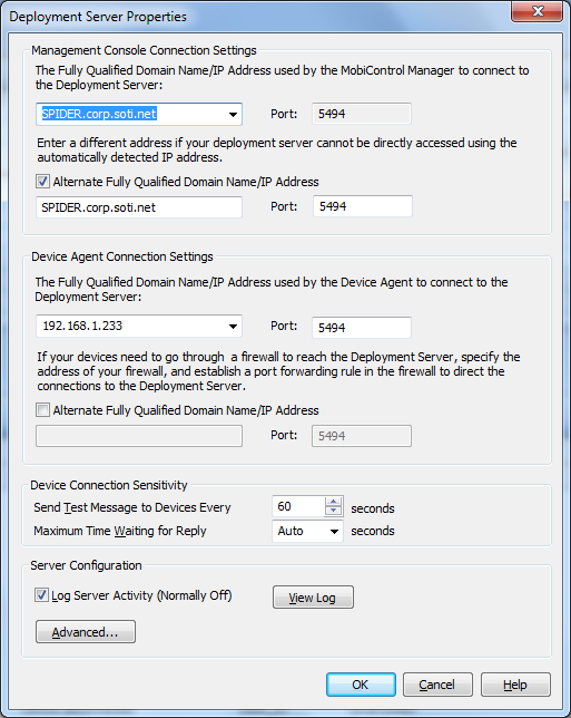

![]() ConnectivityC1. I created an add device rule, generated a Device Agent, and installed it onto my mobile device. Why doesn't it seem to connect to MobiControl?The most common reason why a MobiControl Device Agent cannot connect to a MobiControl Deployment Server is because there is a firewall between the device and the Deployment Server that is blocking the connection attempt from the device. By default, MobiControl Device Agents open TCP/IP connections to Deployment Servers on port 5494. If this port is being blocked by an intermediate firewall—personal or corporate firewall—then the device will not be able to connect to the server. A personal firewall is one that on the computer that is running the Deployment Server. For example, the Windows XP firewall (typically running by default) blocks several TCP/IP ports including port 5494. If you are running a Windows XP or other firewall on a computer that is running a MobiControl Deployment Server, make sure that TCP/IP port 5494 is not being blocked. If your devices are external from your corporate network and need to go through a corporate firewall to get to MobiControl Deployment Server(s), you will probably need to configure external IP address(es) for Deployment Server(s) and then set up firewall rules to map the connections from devices to internal Deployment Server IP addresses. The following steps describe how to configure external IP addresses for your Deployment Servers:
If you have multiple Deployment Servers, you need to configure a different external address for each server. Once you have configured external addresses, you need to generate new MobiControl Device Agents and install them on your mobile devices. The Device Agents will now use the external addresses to connect to Deployment Servers. To be able to establish remote control sessions to external mobile devices or devices whose IP addresses are not public, you need to set the MobiControl remote control profile for your devices to TCP/IP (SERVER). (The default remote control connection profile setting is just TCP(IP).) You can set the default remote control connection profile when creating device configuration rules or by right-clicking on a device group or device in the MobiControl Manager device tree and selecting the Configure Device(s) menu option.
MobiControl Deployment Servers always listen for connections on TCP/IP port 5494; this "internal" port is currently fixed. The Deployment Server properties dialog box in MobiControl Manager allows you to change both the external IP address and the external port for Deployment Servers. If you do assign external IP addresses and ports for your servers, you must create a firewall/proxy server rule to map the external address to the internal IP address and port (5494) of your Deployment Server computers.
If you have configured a
Deployment Server as follows:

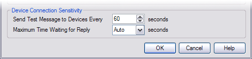

If you have multiple Deployment Servers configured, you can repeat the above test for each Deployment Server in the list. C3. What settings should I use for slow connections?You can set the device connection sensitivity Send Test Message to Devices Every value to 60 seconds in the Deployment Server tray applet. This setting is used to control how often the Deployment Server is to check connections to devices to see if they are working properly. The Deployment Server does this by sending a test message to the device. When the device receives the test message, it sends the message back to the server. If the server does not receive the test message back within a certain time, it will terminate the connection to the device. Another setting that will help slow connections is one that reduces the colors sent in images, which consequently reduces the amount of data that needs to be sent. You can change the remote control connection settings to view the device display in 16-color grayscale or 4-color grayscale instead of the default full-color display. Please see R1. What settings should I use to remotely manage and establish remote control sessions to devices over cellular (e.g. GPRS) or dial-up connections? below for more details. C4. Do dynamic IP addresses present a problem for MobiControl?A dynamic IP address automatically assigned to a host by a DHCP server is not a problem for MobiControl. Device AgentA1. I installed the Device Agent on my device but it is not showing up in the device tree. How can I make it appear?Once the MobiControl Device Agent has been installed on your mobile device, click the MobiControl Device Agenticon on your mobile device. In the pop-up menu, select Configure. When the Device Agent menu comes up, on the General tab, you will see the Status field. If it says disconnected, click the Connect button to establish a connection with the MobiControl Deployment Server. If the status shows "Connected," check MobiControl Manager to see if your mobile device is showing up or not. Once the connection is made, it can take a few minutes for the mobile device to show up in MobiControl Manager. If the status shows "Disconnected" and nothing happens after clicking the Connect button, then the mobile device is not being able to connect with the Deployment Server. Click the Servers tab to verify that the server information is correct. If it is correct, select that entry and click Test. The test should complete successfully. If it does, go back to the General tab and click Connect. If the Deployment Server test fails, verify the Deployment Server information and make sure that the Deployment Server is running. If the Deployment Server information is not correct, please correct it. A2. How can I make sure that the clocks on my mobile devices have the proper time?MobiControl supports two forms of time synchronization: Sync Time with MobiControl Deployment Server and Sync with SNTP/NTP Time Server. Sync Time with MobiControl Deployment Server: When you enable this option, the MobiControl Device Agent will synchronize the device clock with the Deployment Server clock each time it connects to a Deployment Server. To use this option, you must enable the device time synchronization settings for a device (or group of devices). In the device tree, select the device or group, then select Configure Device(s) from the Device menu, and then select Time Synchronization. ![]() Device Time Synchronization Settings Sync with SNTP/NTP Time Server: This option uses the SNTP/NTP time synchronization protocol to synchronize the clock on your mobile devices with a public or private SNTP/NTP time server. You can configure this option using the MobiControl Manager. The most common problem with this form of time synchronization occurs when there is a personal or corporate firewall between your mobile device(s) and the time server. To correct this problem, please make sure that connections from your mobile device(s) through UDP port 123 are not being blocked by a firewall. Please see the Device Time Synchronization page for more information on this topic. A3. Why is the MobiControl Device Agent changing the server host name/IP address information that I am configuring on the device?The Device Agent is not changing the host name/IP address information on its own. It is the MobiControl Deployment Server that is sending what it believes is the correct address information to the device and asking the Device Agent to update its address information. When a device connects to a server, the server sends the device what it believes to be the addresses of MobiControl Deployment Servers. The MobiControl Device Agent then stores the server address information it receives and overwrites the previously configured address information. In order for changes to the host name/IP information to stay, you need to configure this with MobiControl Manager:

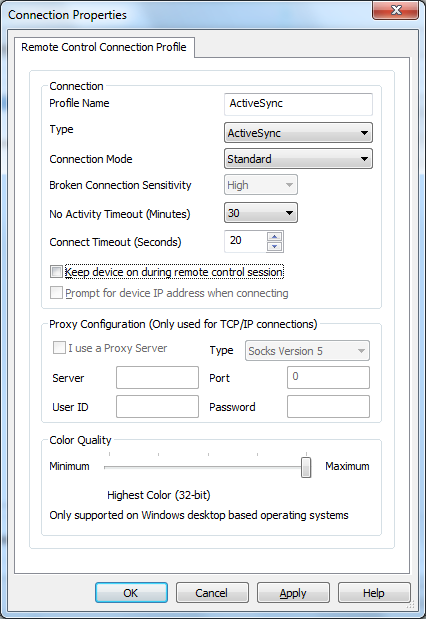

Remote ControlR1. What settings should I use to remotely manage and establish remote control sessions to devices over cellular (e.g. GPRS) or dial-up connections?Cellular and dial-up connections are typically low bandwidth (slow) connections. The information in this section applies to low bandwidth connections but also to other forms of connections such as Wi-Fi. Two of the main factors that affect battery consumption on mobile devices are the device screen and the device radio. Most devices include a control panel applet to adjust screen power consumption. We recommend that you adjust the screen settings to minimize power consumption based on your usage patterns. To limit the amount of power consumed by Wi-Fi and/or cellular radios, you need to minimize the amount of data sent and received by radio(s). The information in this section describes how to minimize the amount of data sent and received by MobiControl Device Agents. Carrier charges can also be an issue. If you are using a cellular connection (e.g. GPRS/EDGE), your carrier may be billing you based on the amount of data that you send or receive through their network. The information provided below describes various MobiControl settings that can be tuned to minimize the data transmitted on cellular networks. Device to Server Connectivity Settings
For remotely controlling devices over slow networks, MobiControl provides options to reduce the amount of data that is sent over these networks. A second characteristic of these sorts of connections is that the IP address of the device is often private, meaning that MobiControl remote control desktop software will not be able to initiate a TCP/IP connection to the device. To deal with the private device IP address issue MobiControl has a TCP/IP(SERVER) setting which allows MobiControl to use a connection initiated by the mobile device for remote control purposes. The following table summarizes the various options available for establishing remote control sessions to mobile devices over slow connections and also devices that have private IP addresses:
You can edit one of the existing remote control profiles and make the changes listed above or create a new profile. The MobiControl installation software creates a remote control profile called TCP/IP (SERVER) by default. It can be edited. ![]() Once the changes have been made, right-click on the device or device group (if you want to use the profile for a group of devices) in MobiControl Manager and make sure that the remote control profile you just edited is configured for use.
When attempting remote control sessions to devices from outside a firewall (i.e. device located on the inside) or to devices on cellular networks that assign devices with private IP addresses, the MobiControl TCP/IP (SERVER) connection type must be used. The TCP/IP (SERVER) connection type allows devices with private IP addresses to be remote controlled by using connections initiated by mobile devices for remote control purposes. If the devices and the MobiControl Manager console are both on the same network the TCP/IP (DIRECT) remote control profile can be used. R2. How can I use MobiControl to manage and/or remote control devices whose IP address is not reachable or not public (i.e. external or private addresses) as is often the case for GPRS connections?The MobiControl desktop software does not need to initiate connections to devices, instead the MobiControl device software connects to servers. If the MobiControl Device Agent software is installed on a mobile device, it will attempt to connect to a Deployment Server and maintain that connection. In this way the desktop software does not need to connect to the device, it just uses the connection that the device software maintains to the server. Since the desktop software does not need to initiate connections to devices, dynamic device addresses are also not a problem. MobiControl also allows external IP addresses and ports to be assigned to Deployment Servers. In this way devices can connect to external addresses that then get mapped to internal addresses and ports by firewall or proxy software. When initiating remote control sessions to devices with private addresses you need to use the TCP/IP (SERVER) connection profile. TCP/IP (SERVER) remote control sessions use device-initiated connections to provide remote control, in this way remote control sessions go through an intermediate MobiControl Deployment Server. In situations where devices do not have private addresses, using regular TCP/IP remote control profiles allows direct connections to devices with no intermediate servers. If a regular TCP/IP remote control profile is used, the connection is initiated from the desktop software. R3. I need to remote control a device that is in the sleep or standby mode and is currently offline. How can I wake up the device and force it to connect to MobiControl?If your mobile device is not showing up as online in MobiControl Manager and you want to establish a connection, you can do so with MobiControl's Send SMS (to initiate connection to MobiControl) feature. (Please see the Sending Messages / Scripts page.) It may be that your mobile device is in a suspended state (sleeping), or the data connection is not active. With the Send SMS (to initiate connection to MobiControl) feature, you can wake up the mobile device, activate the data connection, and have the mobile device connect to MobiControl. R4. Why do I get a Rapi initialization timeout error when I try to remote control my mobile device?Rapi Connection Error When you receive the connection error "Rapi initialization timeout error" while trying to connect to your mobile device, it means MobiControl cannot communicate with Microsoft ActiveSync or WMDC and your mobile device. To resolve this error make sure you have your mobile device properly connected to your computer and to ActiveSync or WMDC. SecurityS1. How do I put pictures into my lockdown menu?Lockdown menus are based on HTML template files. When you install MobiControl several sample template files are installed into the system. To create a lockdown menu screen with your own custom look and feel, open up one of the existing template files, and save it to a different file name. You can then edit the saved HTML template file and give it your own style. If you want to display images in the menu, then you need to make sure that the image files are located in stable storage on your mobile device. MobiControl does not automatically copy images referenced in template files to mobile devices. You can copy the images to your mobile devices either manually via a File Explorer tool, or you can get the images to your devices by using deployment rules or file sync rules. The destination location for images needs to be in stable storage. The image files can be referenced by their absolute path on the mobile devices that they reside on. Once you have finished creating your HTML template file, add the new template to MobiControl and then use it to configure lockdown rules. Please see the Device Lockdown page and the Customizing Lockdown Program Menu Templates page for more information about creating and customizing template files. S2. How can I restrict what a user of the MobiControl Manager console can do?MobiControl includes a security system that integrates with your existing Windows Domain security system (Microsoft Active Directory). You can configure permissions for your domain users, and MobiControl will allow or disallow access to specific functionality based on the permissions configured for the currently logged in user. Please see the Manager Console User Security page for more information. Package Creation and DeploymentPD1. How do I deploy registry settings?To deploy software, data or settings to your mobile devices, you need to
