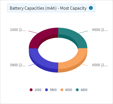

Top Battery Capacities
Categorizes devices by their battery capacity. Select a segment to analyze devices with a common battery capacity. View the breakdown of rated battery capacities (for example, how much charge a brand-new battery has when fully charged), belonging to devices that have reported data to SOTI XSight.
Battery Status - Top Battery Capacities
How to use this chart
View your device fleet based on rated capacity and filter your devices based on battery capacity
Calculation
Each segment shows the percentage of devices by rated battery capacity in mAh based on the Top X rated battery capacities.
Configurations
Dashboard users can change how many top-rated battery capacities show on the chart. Changes to this dashboard are specific to the user and are not applied globally to all users.
Known Limitations
Some devices report their rated battery capacities incorrectly.

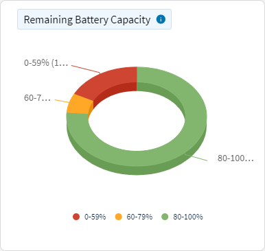

Remaining Battery Capacity
Categorizes batteries by their remaining charge capacity.
Battery - Remaining Battery Capacity
Description
This chart shows the breakdown of the battery health of devices based on maximum charge the device’s battery can hold relative to when it was new.
View device batteries that no longer hold at least 75% of their originally rated charging capacity. Batteries that hold less than 75% capacity are not reliable and most manufacturers recommend replacement.
Calculation
An estimation of a battery’s remaining capacity occurs when:
  • The device’s battery level is 90% to 100%.
  • The device is charging.
The SOTI XSight Agent estimates the remaining capacity by measuring how much charge (in mAh) a device’s battery accumulates as the battery level changes. It then extrapolates that measurement to estimate how much charge (in mAh) a battery would hold if fully charged. This displays as a percentage of the original rated capacity
The Remaining Battery Capacity categories are:
  • Good: Estimated to hold at least 75% of its original rated capacity while the device reports the battery as fully charged.
  • Average: Estimated to hold 50% to 74% of its original rated capacity while the device reports that battery as fully charged.
  • Bad: Estimated to hold less than 50% of its original rated capacity while the device reports the battery as fully charged.
Known Limitations
Some devices report their rated battery capacities incorrectly so categorization of batteries by remaining battery capacity may be wrong for those devices.
Since this dashboard treats batteries as an extension of the device, swapping batteries in and out of devices may result in wrong calculations of the remaining battery capacities.

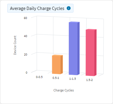

Average Daily Charge Cycles
Average daily charge cycles of a battery within the specified date range.
Battery - Average Daily Charge Cycles
Description
This chart shows a breakdown of the average daily charge cycles during the date range specified. The completion of a charge cycle occurs when the combined levels of charging and discharging reach 100%. For example, if you discharge your fully charged battery 20% and charge it back to full and repeat it 5 times, this would count as one battery cycle.
View batteries that underwent several charge cycles over a short duration of time. This may indicate that devices/apps are rapidly draining the batteries, intense device usage or the batteries may be nearing the end of their life cycle.
Calculation
Sum of all charge cycles (as defined above) that a device’s battery goes through during the date range specified in the dashboard.
There are 4 groups of devices, depending on the number of charge cycles they have completed:
  • 0 to 4 charge cycles.
  • 5 to 9 charge cycles.
  • 10 to14 charge cycles.
  • 15 or more charge cycles.

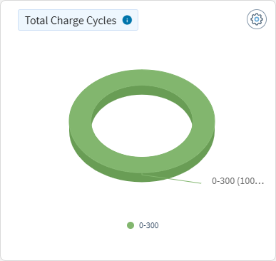

Total Charge Cycles
Total number of charge cycles a battery has undergone. A charge cycle is equivalent to the battery being drained to 0% and then fully charged.
Battery - Total Charge Cycles
Description
This chart shows a breakdown of device batteries by the number of charge cycle increases since enrollment until the selected end date. A battery completes one charge cycle when charged and discharged an amount equal to 100% of its full capacity five times.
Identify batteries that may be nearing the end of their useful life. Batteries are typically rated for a certain number of charge cycles. Once past that threshold, they are no longer considered reliable.
Calculation
The sum of charge cycles that a device goes through since its enrollment to the end of the date range specified in the dashboard.
There are 4 groups, depending on the number of charges cycles the device have undergone:
  • 0 to 149 charge cycles.
  • 150 to 497 charge cycles.
  • 498 to 1000 charge cycles.
  • 1000 or more charge cycles.

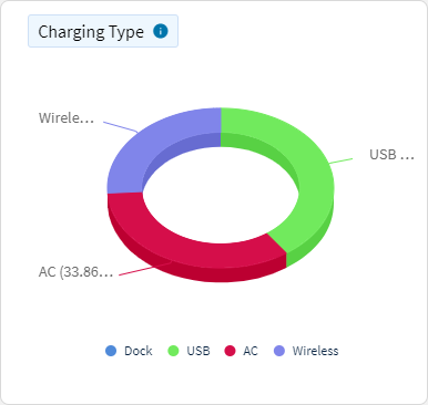

Charging Type
Categorizes devices by the charging method employed. Click on segments to analyze devices with a common charging method.
Bettery - Charging Typep
Description
This chart shows a breakdown of predominant charging types for devices during the date range specified in the dashboard. Charge types consist of one or more charging sessions. The charging type classifications are:
  • AC: A charging session using an AC charger.
  • USB: A charging session using a PC or another device for charging.
  • Wireless: A charging session using a wireless charger.
Charging a device in a certain way can impact the life of its battery. Wireless charging, for example, can heat up the battery and can degrade a battery’s long-term performance. In general, it is better to avoid wireless charging when possible.
Calculation
Every hour, the chart identifies charging sessions for devices as AC, Dock, USB or Wireless, using the charge type definitions above. On a given day, if a device does not go through any charging session, it reports as No Data. There are five groups (AC, Dock, USB, Wireless or No Data) depending on the most frequent charge type seen during the date range specified in the dashboard. In the case of ties, the designation of Wireless takes precedence over AC, which takes precedence over USB, which takes precedence over No Data.
