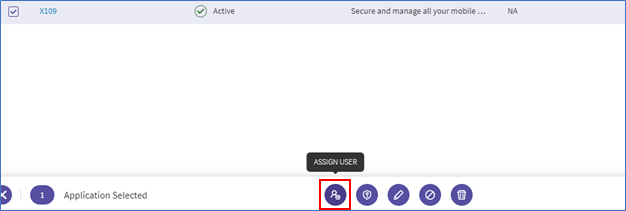

Assign SOTI MobiControl role to SOTI Identity user/group
                    Select Assign User in your SOTI Identity application.
                    Select your user/group
