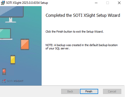

				Wait for the installation process to complete and select
						Finish.
				Manually restart the SOTI XSight Management Server
					service.
				Manually restart SOTI MobiControl Deployment Server service.
				In the SOTI XSight Admin Utility, ensure all the SOTI XSight System Health services are running.
				In the SOTI XSight Admin Utility, ensure all the SOTI XSight System Status services are running.
The installer has setup SOTI XSight and configured it to work with SOTI MobiControl.
