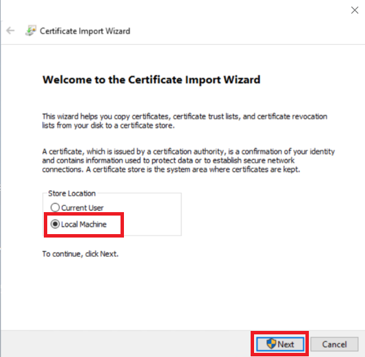

                                     -  In the Certificate Import Wizard, select
                                    Local Machine and then select
                                    Next.

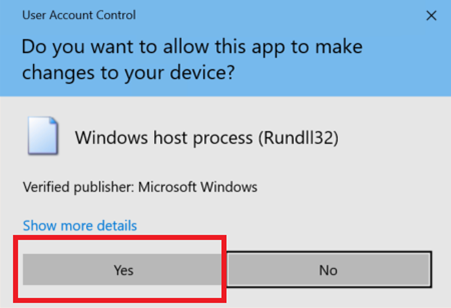

                                     - Select Yes.

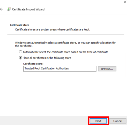

                                    Place all certificates in the following
                                    store and then select Browse.
                                     - Select the Trusted Root Certification
                                    Authorities certificate store, then select
                                    Ok.
                                    Next.

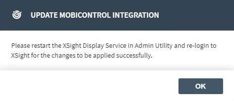

 - Update the settings and select Save.
                    After successfully updating the settings the following prompt
                        displays.
