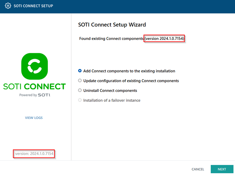

  3. In the installer, select Add Connect components to the existing installation and Select Next.
    SOTI Connect Setup Wizard
    Tip: Confirm that the SOTI Connect Installer is the same as the installed SOTI Connect version. In the earlier screenshot, the version number of the SOTI Connect Installer (red box on the lower left) matches the installed SOTI Connect version (red box on the upper right).

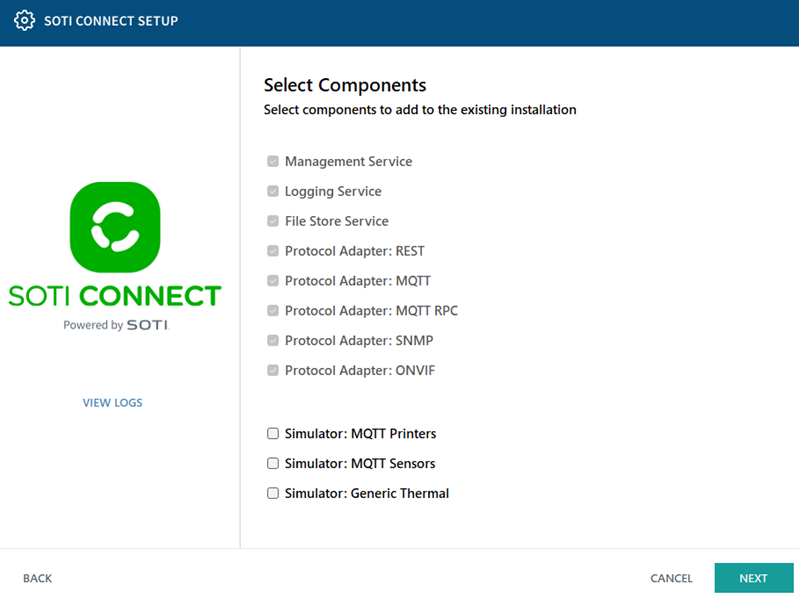

  4. On the Select Components screen, choose the components to add and select Next.
    Note: Installed components appears already selected and greyed out.
