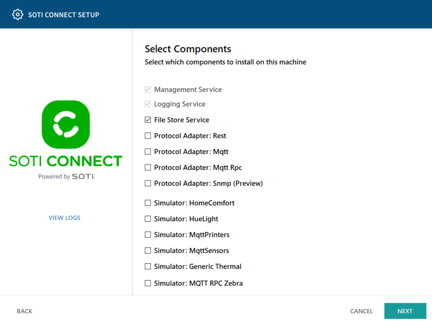

  6. On the Select Components screen, select File Store Service. Select Next.
    Setup Wizard
    Note: If you uncheck any SOTI Connect component, it will be uninstalled.
