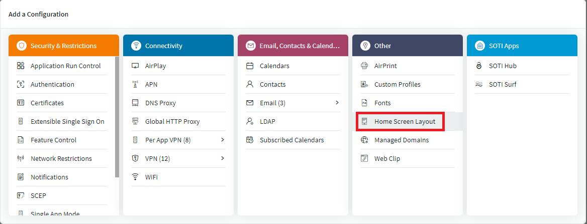

  1. Add a new configuration to a new or existing iOS profile. From the Configurations tab, select Home Screen Layout.
    The Add Configuration screen with Home Screen Layout selected.
