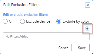

Select the Hide Device icon associated with the device.
The Edit Exclusion Filters panel displays.
- In the Edit Exclusion Filters panel,
- select Off to turn off the exclusion filter for the device.
- select Exclude device to remove the device from the view.
- select Exclude by color to select a topic, and the color of the focus to exclude a device.
- Select Exclude by color to remove devices of the
chosen colors from the view.

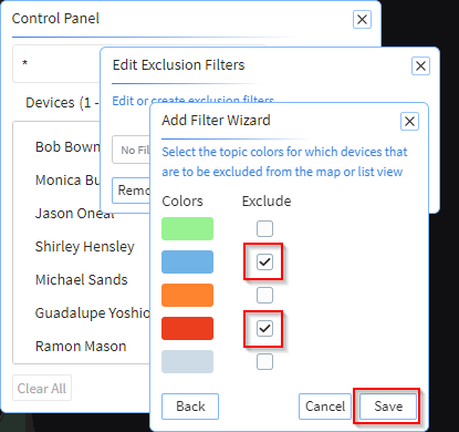

Select the Add filter icon. The Add Filter Wizard panel displays.
- Select a topic in the Add Filter Wizard panel and
select Next. The Add Filter
Wizard panel expands to include a list of colors associated
with the selected topic.Select one or more colors for the selected topic to exclude the device. When the device's topic turns the color of any of the selected colors, the device is removed from the view.
- Select Save. The Edit Exclusion
Filters panel displays, showing the selected topic and
selected colors to use to exclude the device.
