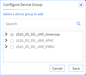

 - In the Filter section, select the Add Filter icon and
                    then choose one of the following filter types:Use filters to target which devices to display in the view.
- Group
 - Location
 - Manufacturer
 - Device Name
 - Indoor Location
Note: 'Group' filter is mandatory, all other filters are optional.
Note: You can add as many filters as needed.Filter Description Device In the Configure Device Group panel, select the groups whose devices you want to add to the view.

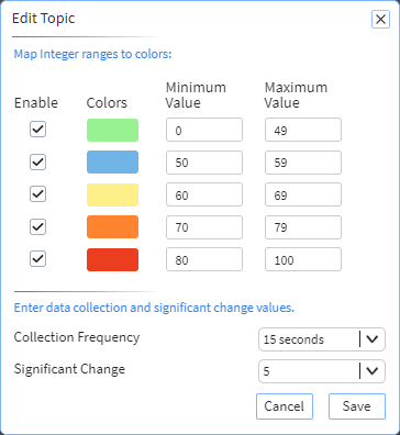

Assigning and Changing the Color of the Rings
The device icons shown in a view's map and list modes indicate the state of a device. The circle icon represents a device. The inner circle, or marble, is the center. The thicker layer is the disk, and the outer layer is the ring. Each part has meaning as determined by you.
You can edit the properties of the circles by highlighting a topic on the Selected list and then selecting Edit.
The Edit Topic panel displays.
You can assign meaning to each color by defining a range during which the color displays. For example, the topic could represent the number of pallets of bottled water in a delivery truck.
Assume that this topic is at the top of the list, represented on the map by the inner marble. The marble shows green when the truck has between 80 and 100 cases of water. When the stock drops to 70 cases, the marble turns blue. If the stock drops below 24 cases, the marble turns red.
Use the Collection Frequency dropdown list to set how often the device sends topic data. Select a value from the Significant Change dropdown to choose an amount of change that must happen before the device sends data. This prevents transmission of every small change, thereby saving unnecessary data usage. You can configure this setting so that expected fluctuation does not generate data. In the example, if the truck's stock of bottled water drops by five cases between collection frequencies, the device sends data.
