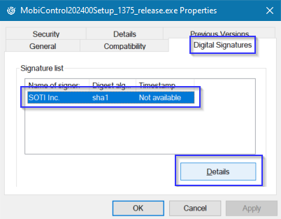

Validate the integrity of the downloaded installer.
- Right-click the downloaded installer and select Properties.
- Select the Digital Signatures tab, select SOTI Inc. in the Signature
list and then select Details.
- In the Digital Signature Details panel, select
View Certificate.
- Check that the Certificate status is OK in
the Certificate panel.

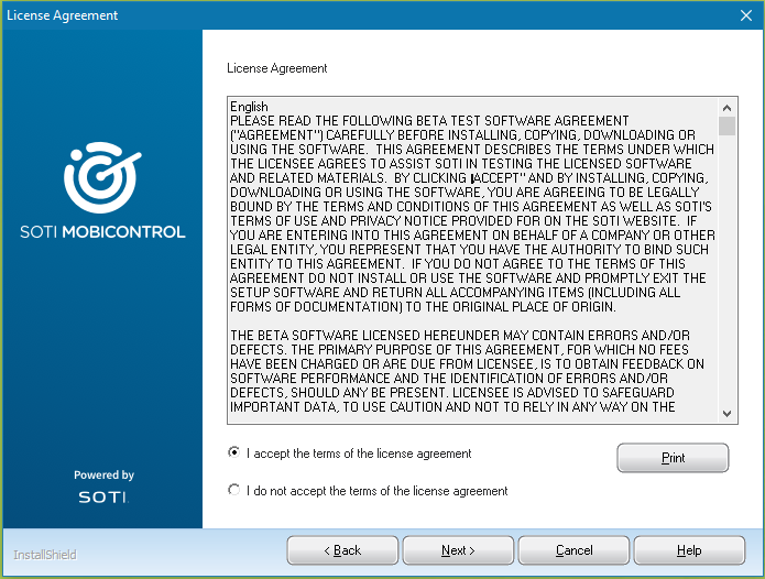

Read and accept the SOTI MobiControl license agreement. You
can print the license agreement for future reference. Select
Next.

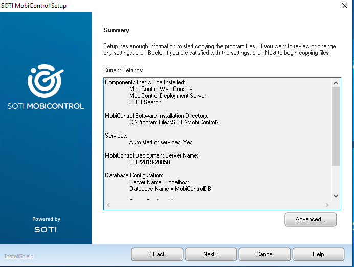

Review your installation settings. Select Next to start
the installation, Back to return to earlier wizard
panels, or Advanced to access advanced installation
settings.
