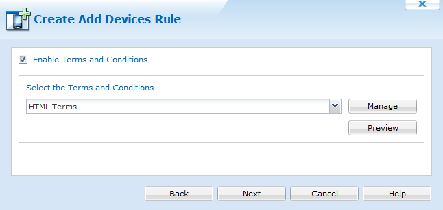

  6. Terms and Conditions
    The terms and conditions page allows us to send terms and conditions to devices. Users must accept these terms before they are able to enroll their device to MobiControl. If they do not accept the terms and conditions, the device will not connect. If Terms and Conditions is required, click "Enable Terms and Conditions".
    Terms and conditions
    To add new Terms and Conditions to the Add Devices rule, click . Once clicked, we can see the Terms and Condition Manager. Please see the Terms and Conditions page for more information.
  7. After selecting the Terms and Conditions, click Next to continue the creation of the rule.

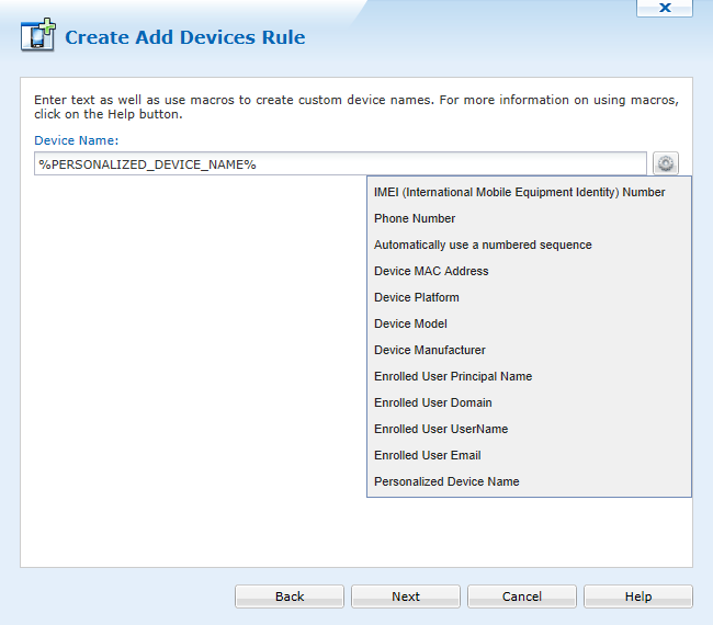

  8. Create custom device name
    User can set custom device name using one or more available macros. The custom device name will appear on Device Configuration tab (on device).
    Create Custom device name
