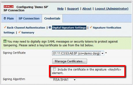

Note: When creating the entry for MobiControl inside your IdP, enable "Include the certificate in the signature <KeyInfo> element" if the option is available.
Example of the option in the IdP Ping Identity:
