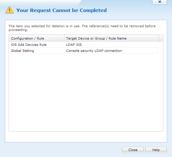

Deleting an LDAP Connection
When you no longer require an LDAP connection, click Delete in the LDAP Connections Manager. If the LDAP connection is still in use somewhere, you receive the error below:
LDAP Connection Delete Warning
MobiControl shows all configurations or rules where this connection is used. It also lists the name of the target device or group/rule name. To successfully delete the connection, you must go through the list to make sure that this connection is not used anymore.
