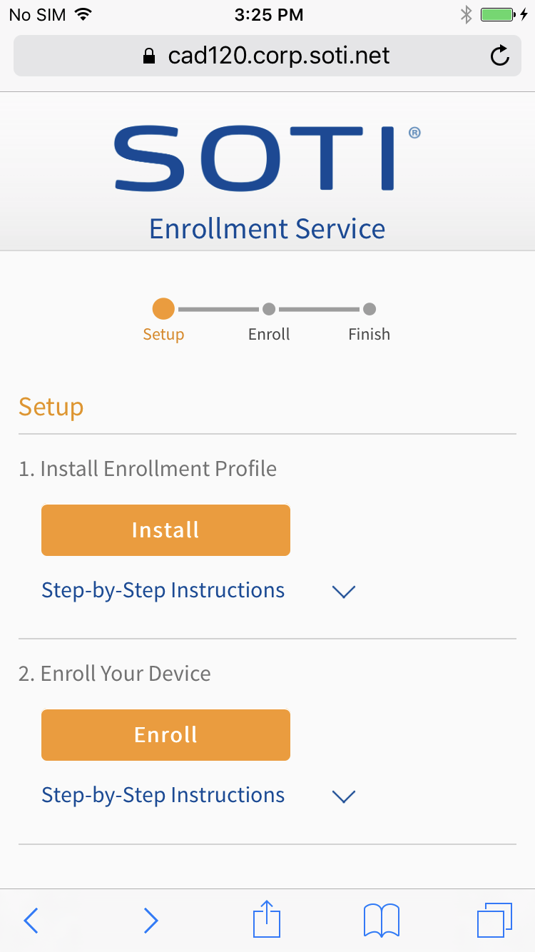

  1. Go to the iOS Enrollment Service Web Page

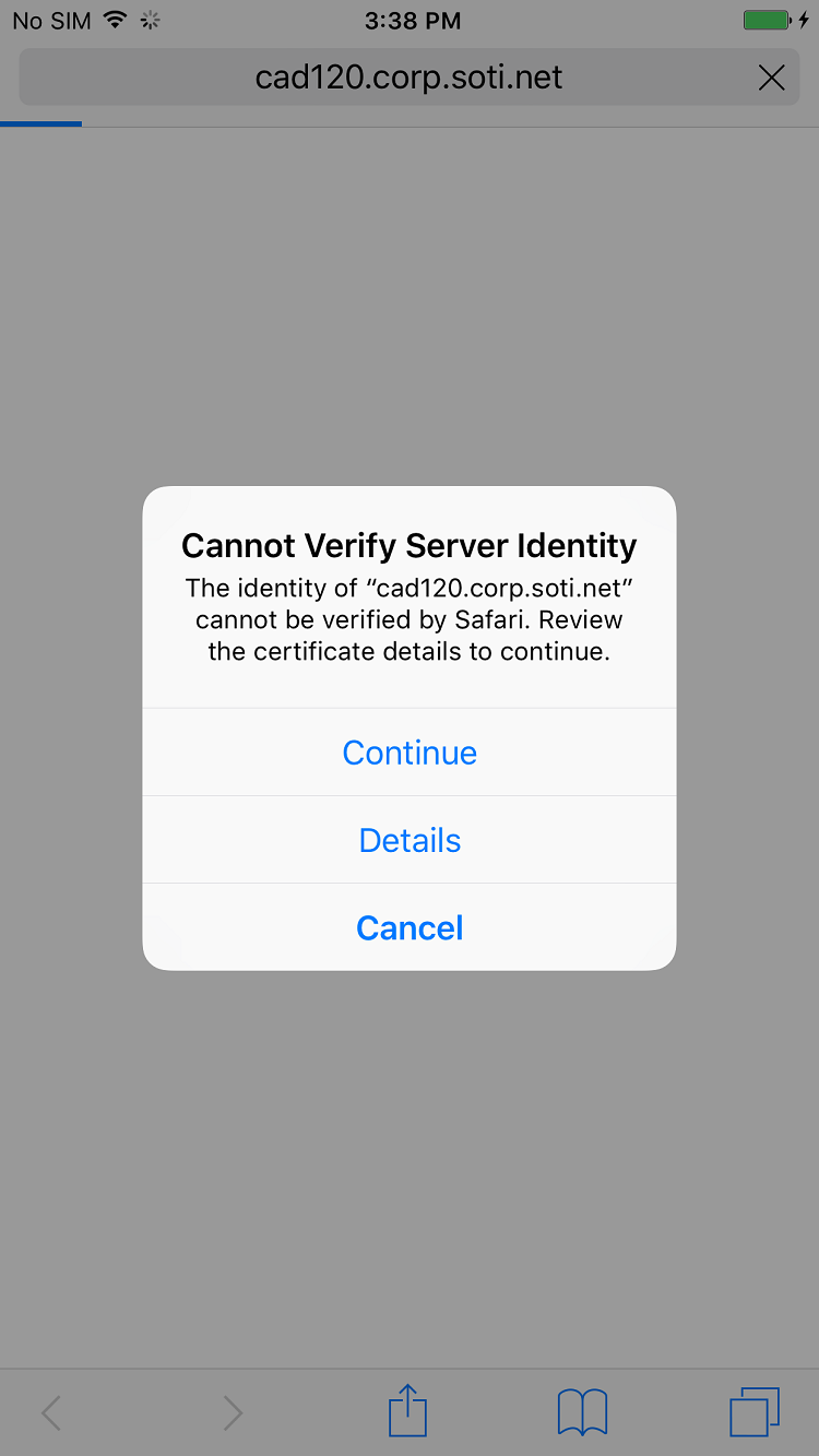

    On the device, open the Safari browser and enter the Enrollment URL from the add devices rule in the address bar. If a pop-up appears, stating that it cannot verify the server identity, tap Continue to ignore the warning and proceed with the enrollment process.
    Cannot Verify Server Identity

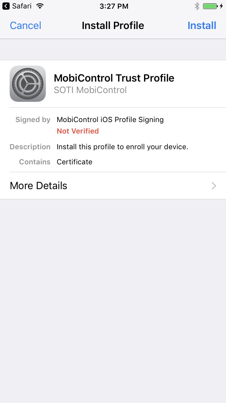

  2. Download the MobiControl Trust Profile

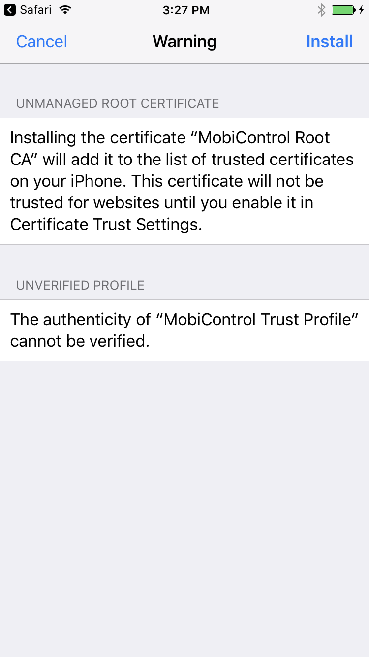

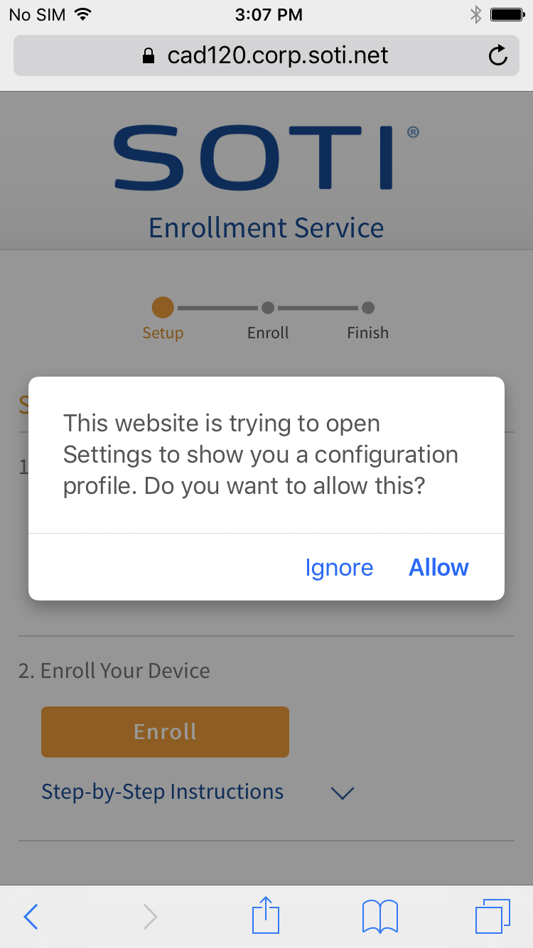

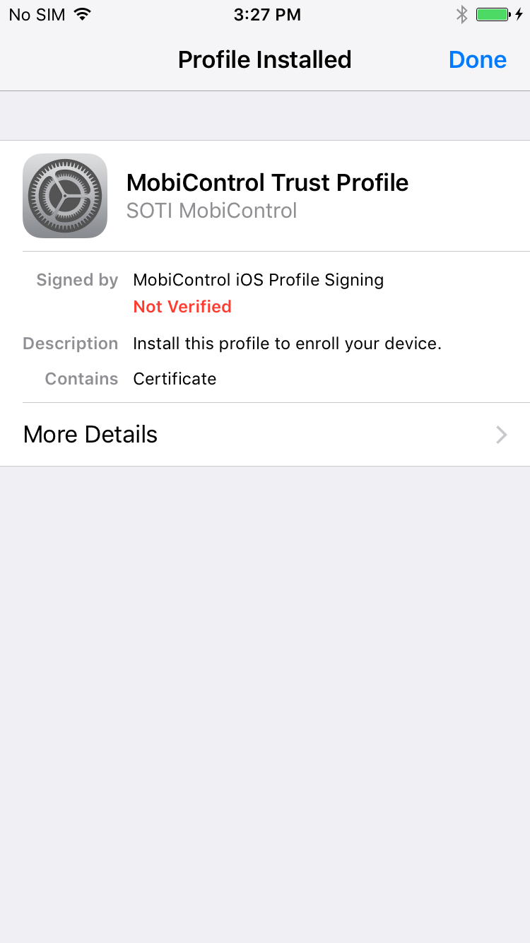

    Tap Step 1 to begin downloading the MobiControl Trust Profile. This Profile installs the MobiControl Root CA certificate on your iOS device. It is necessary to verify the MobiControl Device Enrollment Profile. On devices running iOS 10.3.3 or later, you will be notified that you are being redirected to Settings. Tap Allow to continue. Your iOS device will display a warning message with a brief description of the purpose of the Trust Profile. Tap Install. Once the Trust Profile has finished downloading, tap Install to install the Trust Profile and continue with the enrollment process.
    The iOS Enrollment Service Web Page
    Settings Redirect Prompt
    The Trust Profile
    Trust Profile Installation Warning
    Successful Installation of the Trust Profile

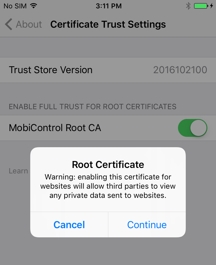

  3. Explicitly trust the MobiControl Root CA Certificate
    This step is only applicable on devices running iOS 10.3 or later.
    On your iOS device, navigate to iOS Settings > General > About > Certificate Trust Settings and activate Enable Full Trust for Root Certificates for the certificate that was downloaded in the previous step. Return to Safari.

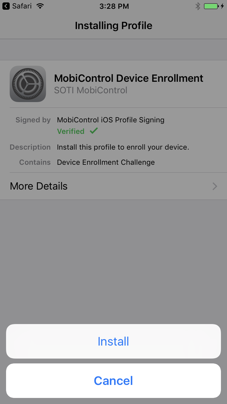

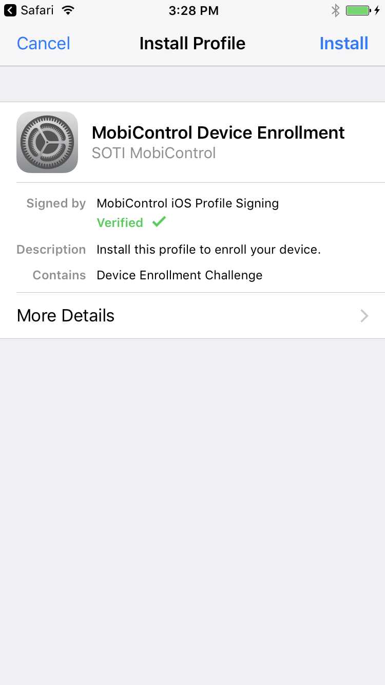

  4. Download the MobiControl Device Enrollment Profile
    Tap Step 2 to download the MobiControl Device Enrollment Profile. On devices running iOS 10.3.3 or later, you will be notified that you are being redirected to Settings. Tap Allow to continue. Tap Install and then Install again to install the MobiControl device enrollment profile.
    The Device Enrollment Profile
    Confirm Installation

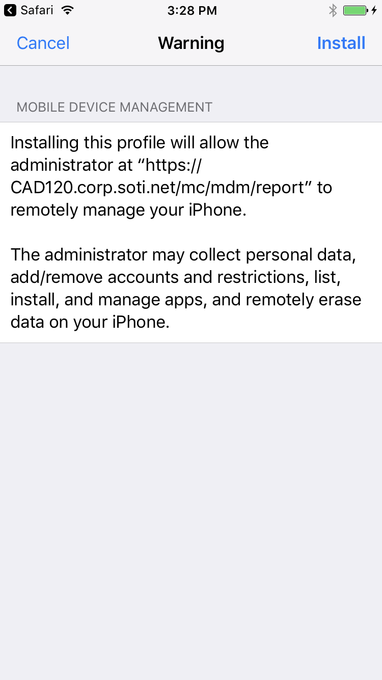

  5. Accept Warning

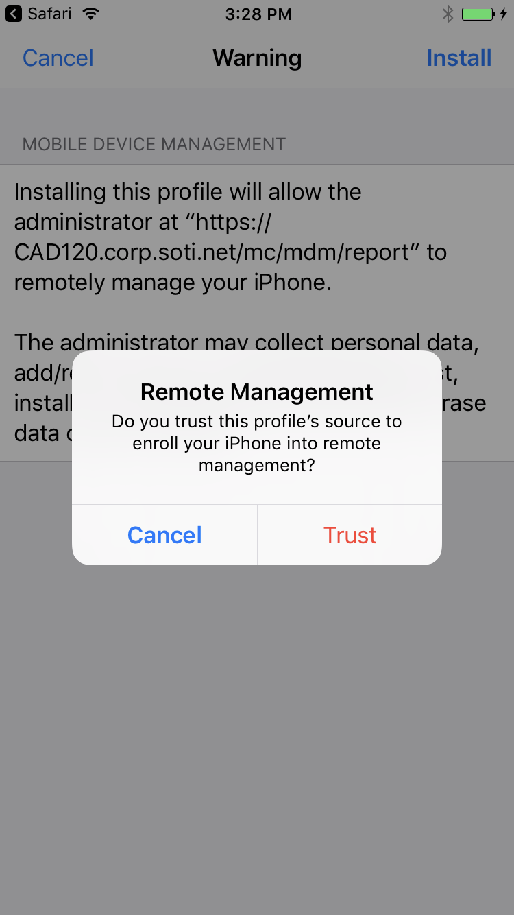

    When you tap Install Now, your iOS device will display a warning message with a brief description of the purpose of the MobiControl Device Enrollment Profile. Tap Trust to continue.
    Warning Message
    Accept Remote Managed

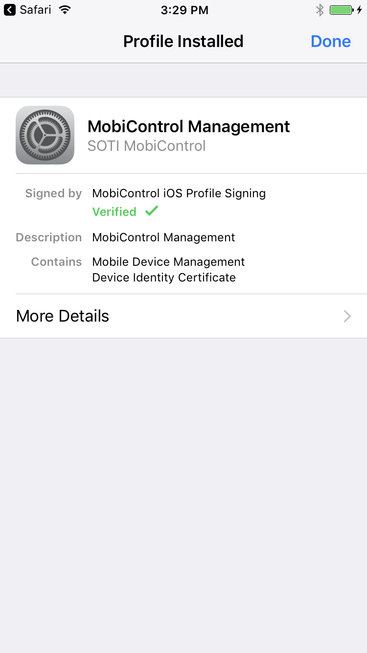

  6. Install Profile
    The installation process of the MobiControl Device Enrollment Profile includes several automatic steps that require no user interaction. Once the profile has finished installing on your device, tap Done.
    13
    MobiControl Device Enrollment Profile Successfully Installed

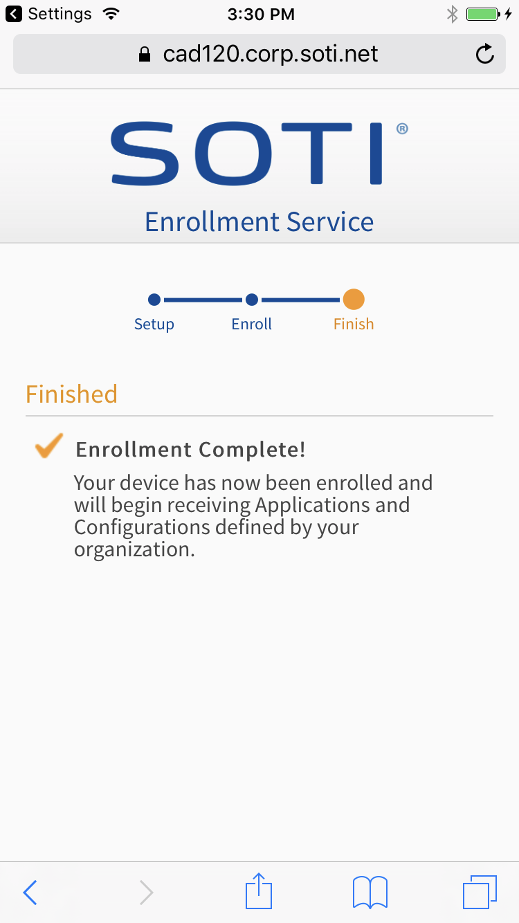

  7. Finish Enrollment
    Congratulations! You have successfully enrolled your iOS device into MobiControl.
    13
    Successful Enrollment
