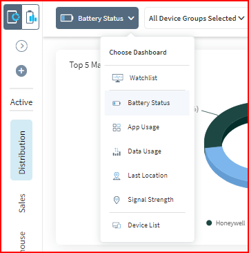

You can view the Battery Status dashboard by selecting it from the dashboard dropdown menu.
