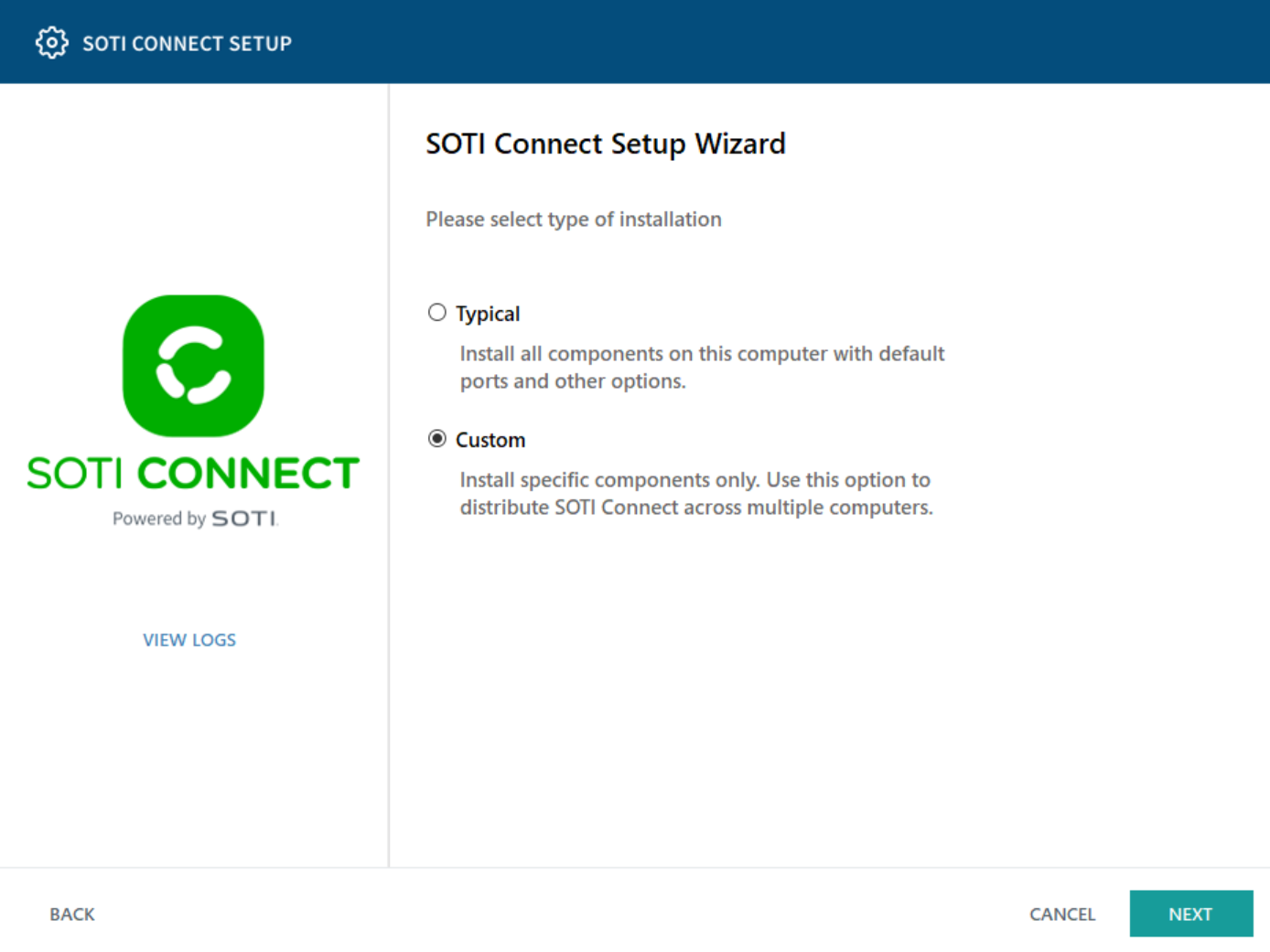

Select Install Connect components, then select
Next. The Installation Type
window displays.
Select Custom, then select Next.
The Select Components window displays.

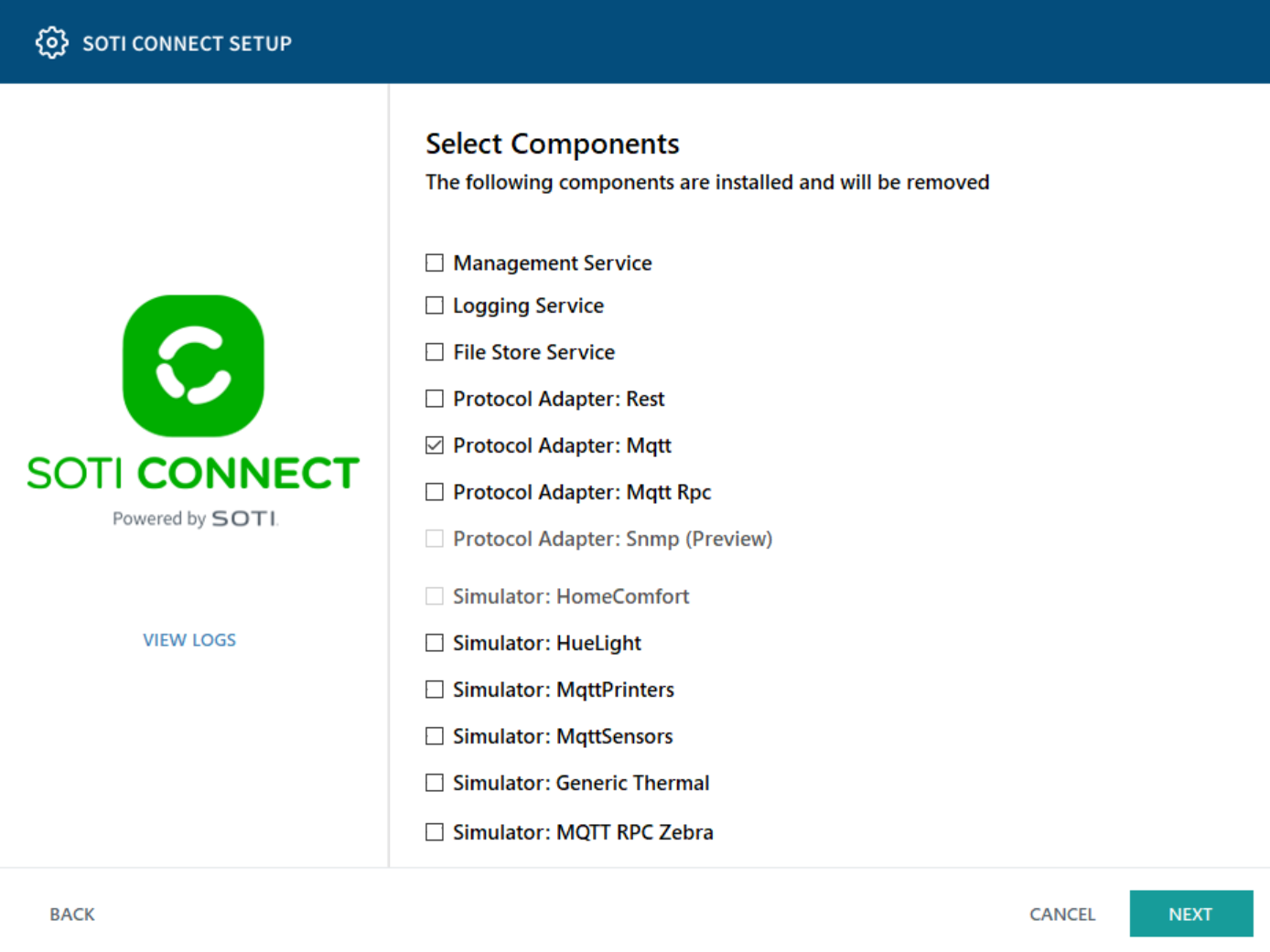

Select Protocol Adapter: MQTT or Protocol
Adapter: MQTT RPC, then select Next. The
Management Service Root Certificate window
displays.
Important: Options for Management Service, Logging Service, and File Store Service should be cleared as these were installed when the MS was established.

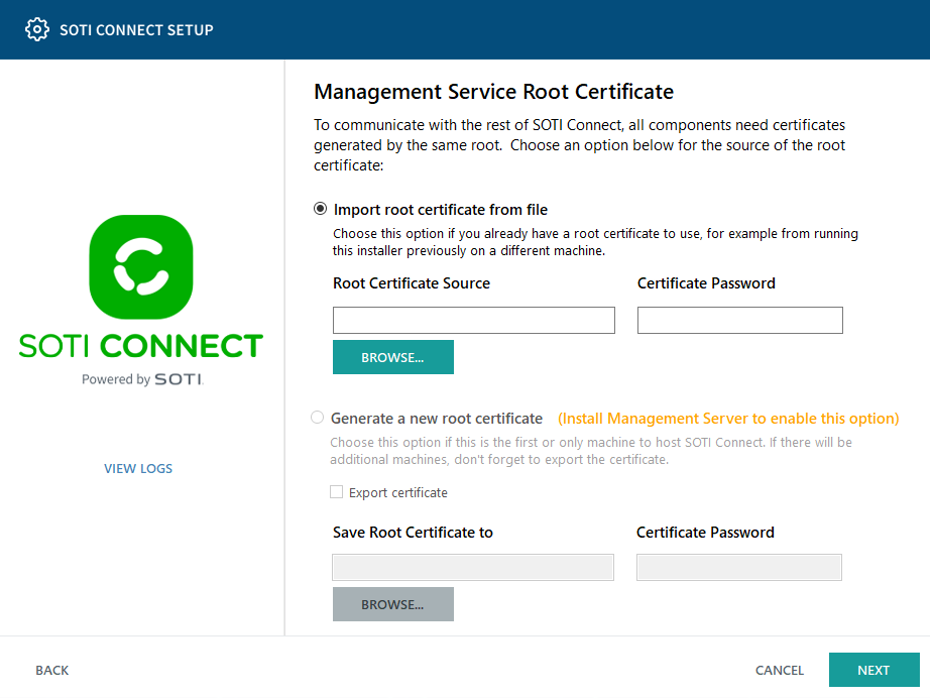

Choose Import root certificate from file, and select
Browse and navigate to the root certificate. Add the
Certificate Password, then select
Next. The Configure MQTT Protocol
Adapter window displays.

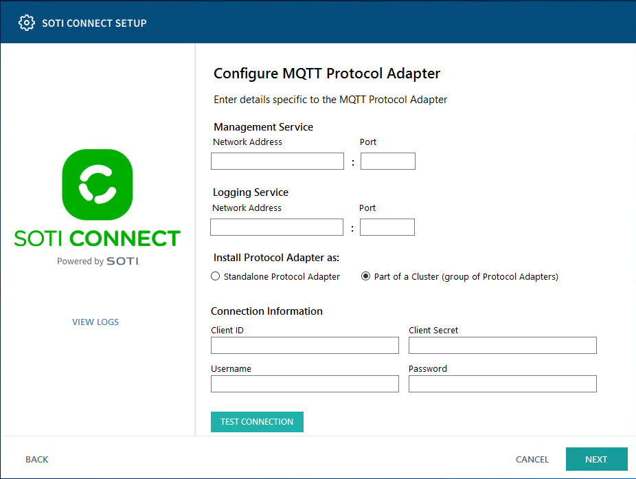

Select Part of a Cluster. Complete the rest of the
fields on this window (the Network Address of Management
Service (MS) and Logging Service. The Client ID and
Client Secret, and the
Username and Password of a
user with administrative permissions).
Note: You must have created at least one security access. See Providing Security Access.
Select Test Connection. If the test is unsuccessful,
check the following:
- Check that the Client ID and Client Secret are correct.
- From this location, open the SOTI Connect web page. Sign in with the Username and Password used earlier. Ignore possible warning messages about the root certificate. It becomes trusted during the installation.
- Sign out on the web page and sign back in. Check and accept the EULA.
Important: A user with administrator privileges must accept the End-user License Agreement (EULA), and must do so whether using a local account or an IDP. - Select Next. The Configure MQTT Protocol Adapter Cluster window displays.

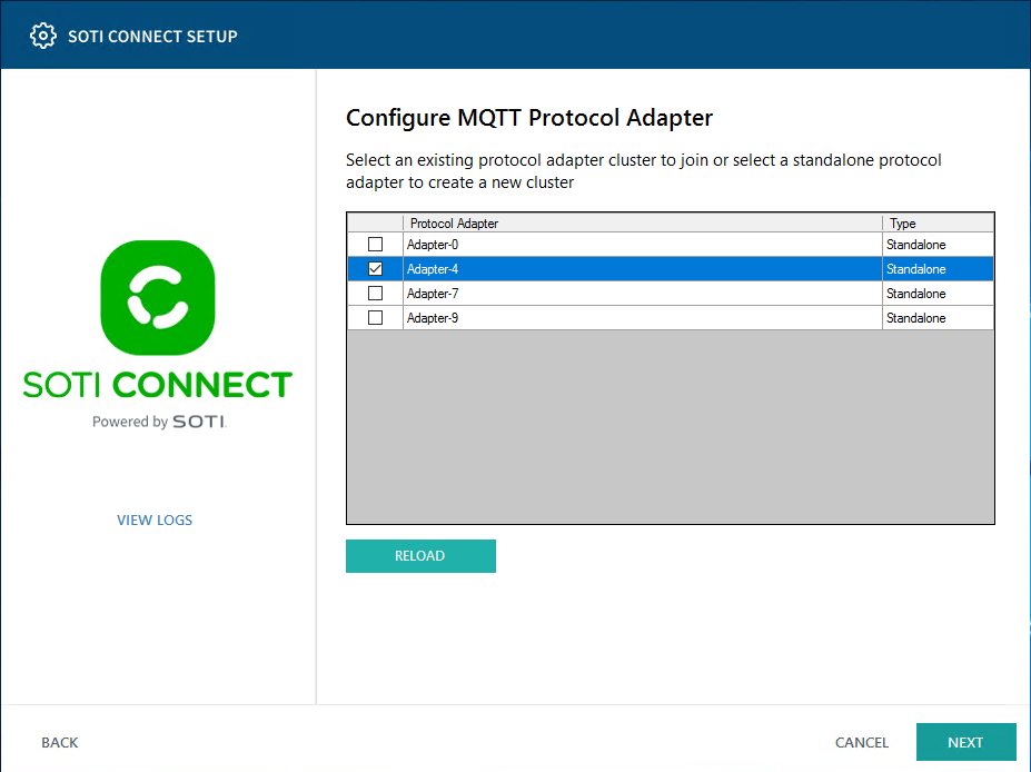

Select an existing PA or PA cluster with which you want to form a cluster, then
select Next. The installer connects to the MS and
requests MQTT broker connection details. Once completed, the Root
Folder window displays.
