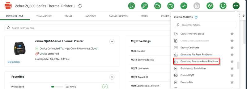

  3. Deploy the firmware to devices. From the device actions menu, select Download Firmware From File Store.
    Download Firmware From File Store device action

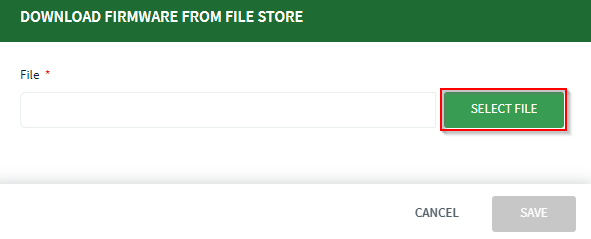

  4. Choose the relevant firmware file, then select Save.
    Selecting firmware upgrade file
