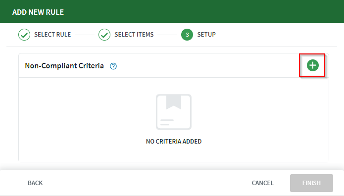

  7. In the Setup tab of the Add New Rule panel, select the Add icon.
    Compliance rule setup

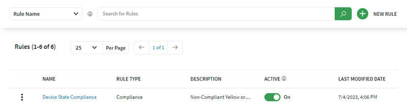

  10. The newly created rule displays in the Rules view.
    Compliance rule newly created
    Note: Newly created rules are active by default.
The new compliance policy is visible in the Rules view with the Rule Type set to Compliance. In the Rules view, you can edit the compliance policy as needed or activate and deactivate it.
