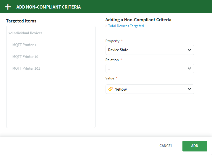

    In the Add Non-Compliant Criteria panel, specify the non-compliant criteria as shown below and select the Add button.
    Compliance rule criteria
    Note: You can add more non-compliant criteria to create a more complex compliance rule.
