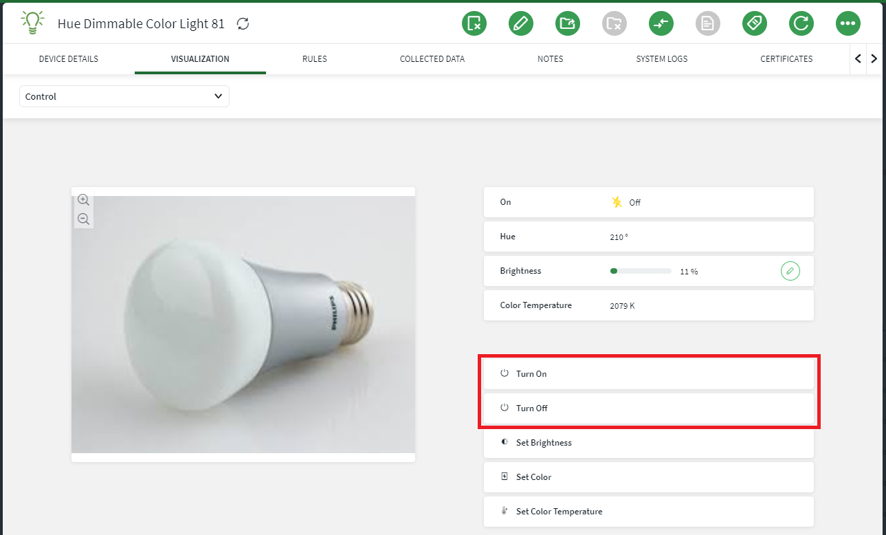

Working with Device Actions Widgets
					Click the Actions widget selector from the left-hand
						menu:
 - Browse the list of available actions for the device type you selected when you created the Visual Board. For more general information, see Using Device Actions.
 - Drag and drop your desired action onto the canvas.
 - Click Update.

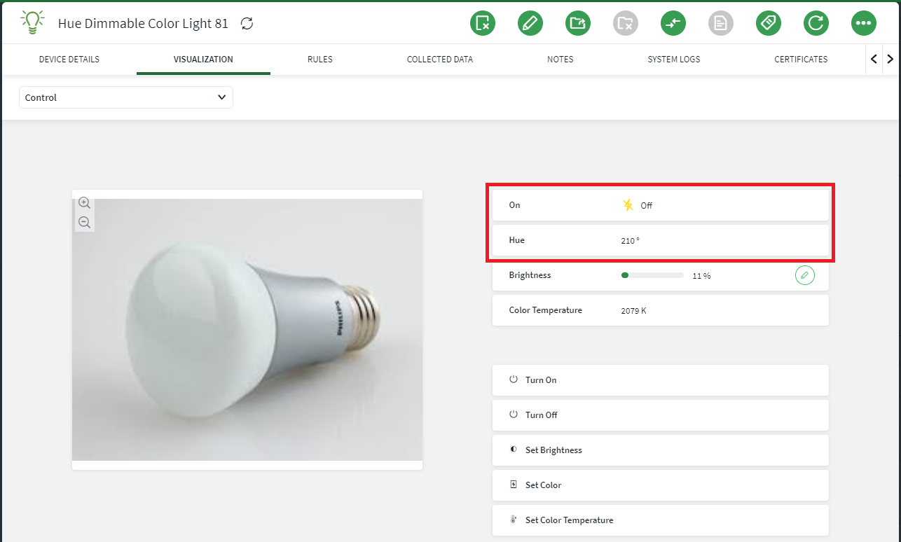

Working with Device Properties Widgets
					Click the Properties widget selector from the
						left-hand menu:
 - Browse the list of available properties for the device type you selected when you created the Visual Board.
 - Drag and drop your desired property onto the canvas.
 - Click Update.
