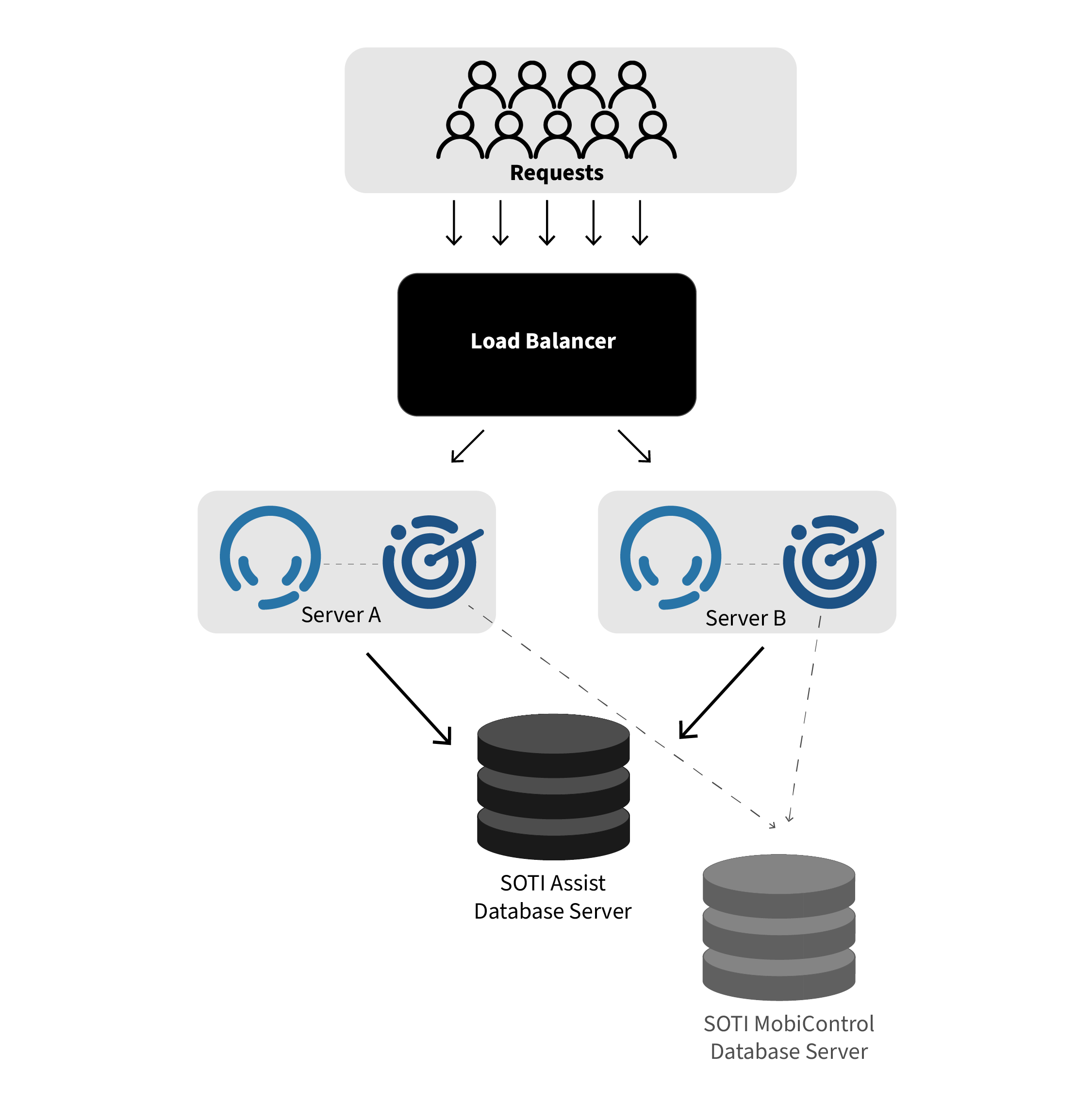

Same Server
Every server in the load balanced environment has both SOTI Assist and SOTI MobiControl installed. Instances of SOTI Assist and SOTI MobiControl on the same server communicate directly with each other and communicate with the other servers through the load balancer.
During installation, you can use relative URLs to configure each SOTI Assist instance to connect directly to the SOTI MobiControl instance that shares its server.

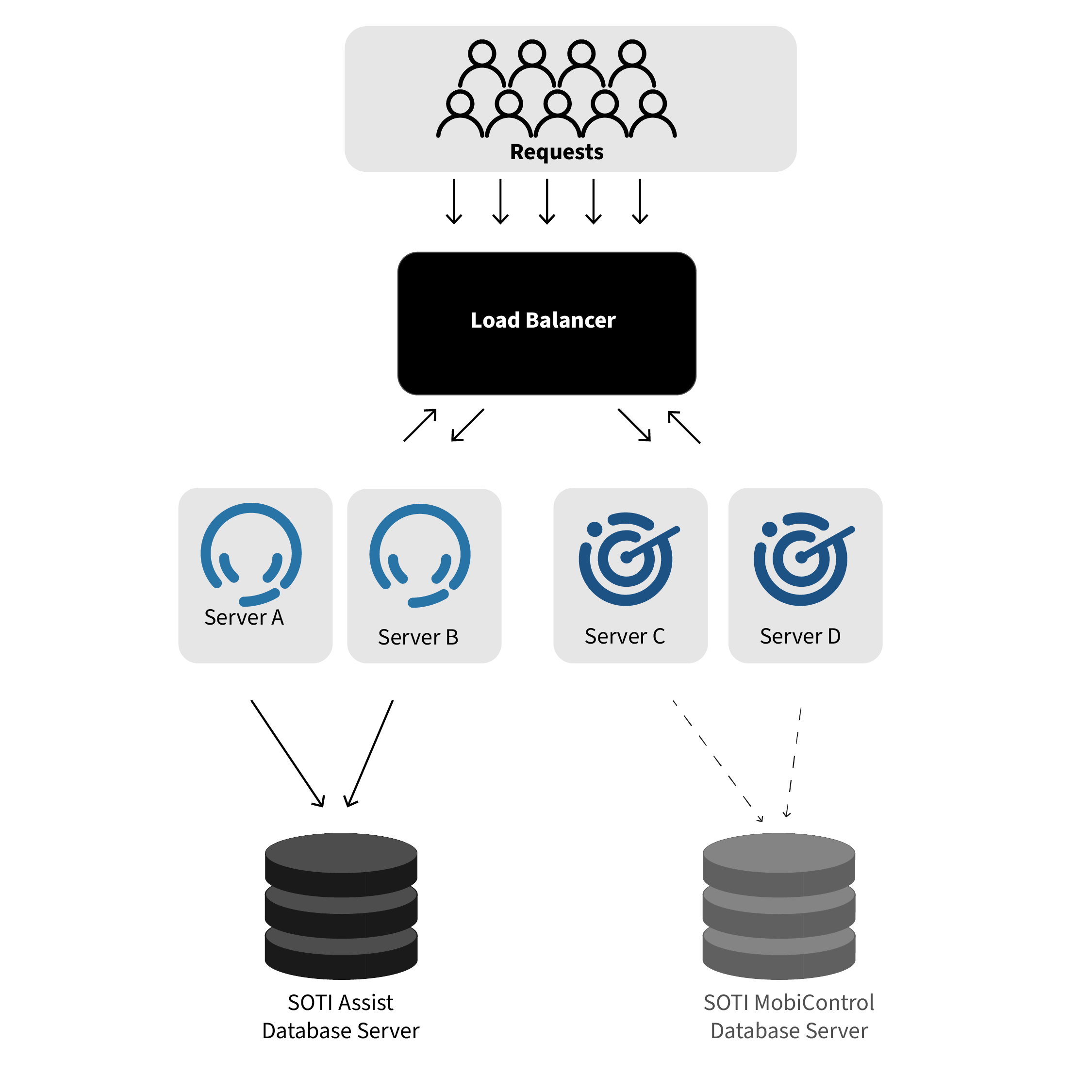

Separate Servers
Each instance of SOTI Assist and SOTI MobiControl is on a separate server. SOTI Assist instance 1 and 2 are on Server A and Server B, respectively while SOTI MobiControl instance 1 and 2 are on Server C and Server D. The servers communicate with each other through the load balancer.
