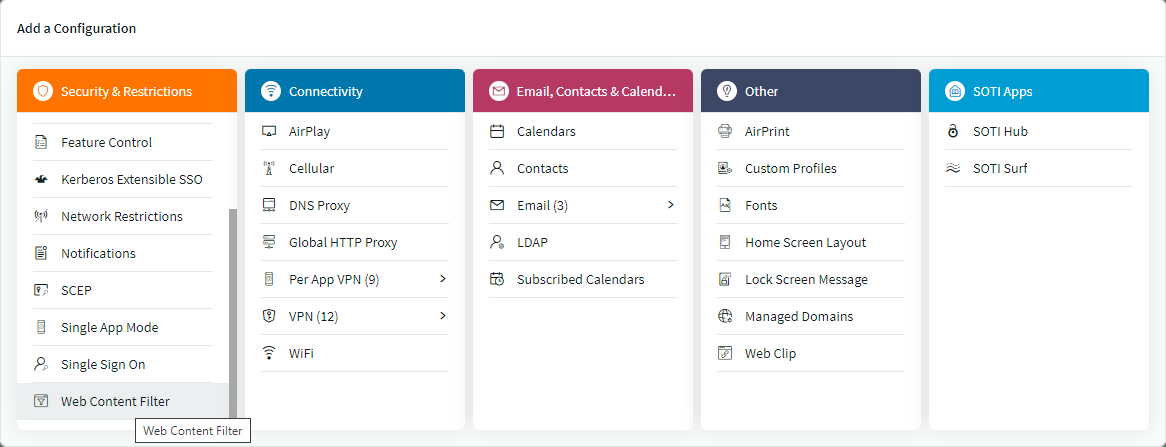

To configure a third-party app to filter device web content, do the following:
                From Create Profile, select the
                        Configurations tab.
- From Profile Configuration, select Add. The Add a Configuration panel opens.
                From Security & Restrictions, select Web
                        Content Filter. The Web Content Filter
                    window opens.
