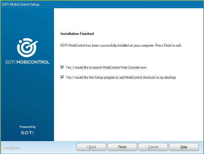

  13. Click Finish to close the installer.
    The SOTI MobiControl components that you selected are now installed on your server. You will need to repeat the installation on any other servers where you want to install SOTI MobiControl components.
    Important: Always use the same installer version on each server. Secondly, stop services on all existing SOTI MobiControl servers using either the SOTI MobiControl Administration Utility or Windows Services. Services are often configured to auto-start so confirm that SOTI MobiControl services are shut off even if you haven't yet launched SOTI MobiControl.
Done! You have successfully installed SOTI MobiControl. Proceed to activation - see SOTI MobiControl Activation.
