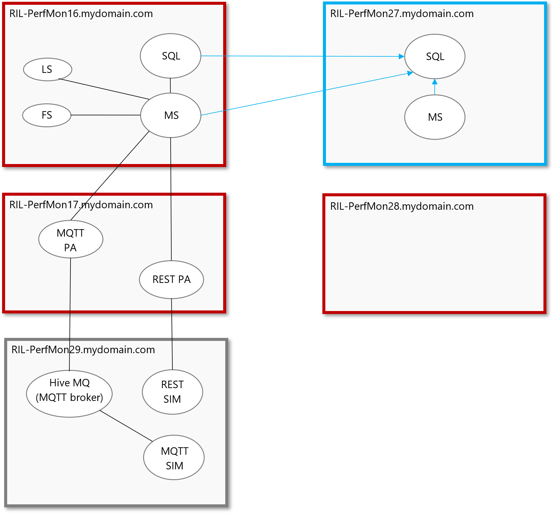

In our example, the environment should appear as follows:

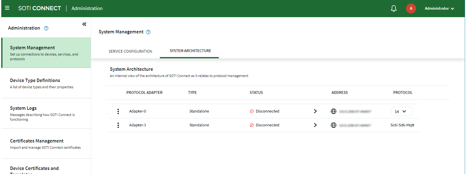

Verify that the source PAs are stopped on the screen.

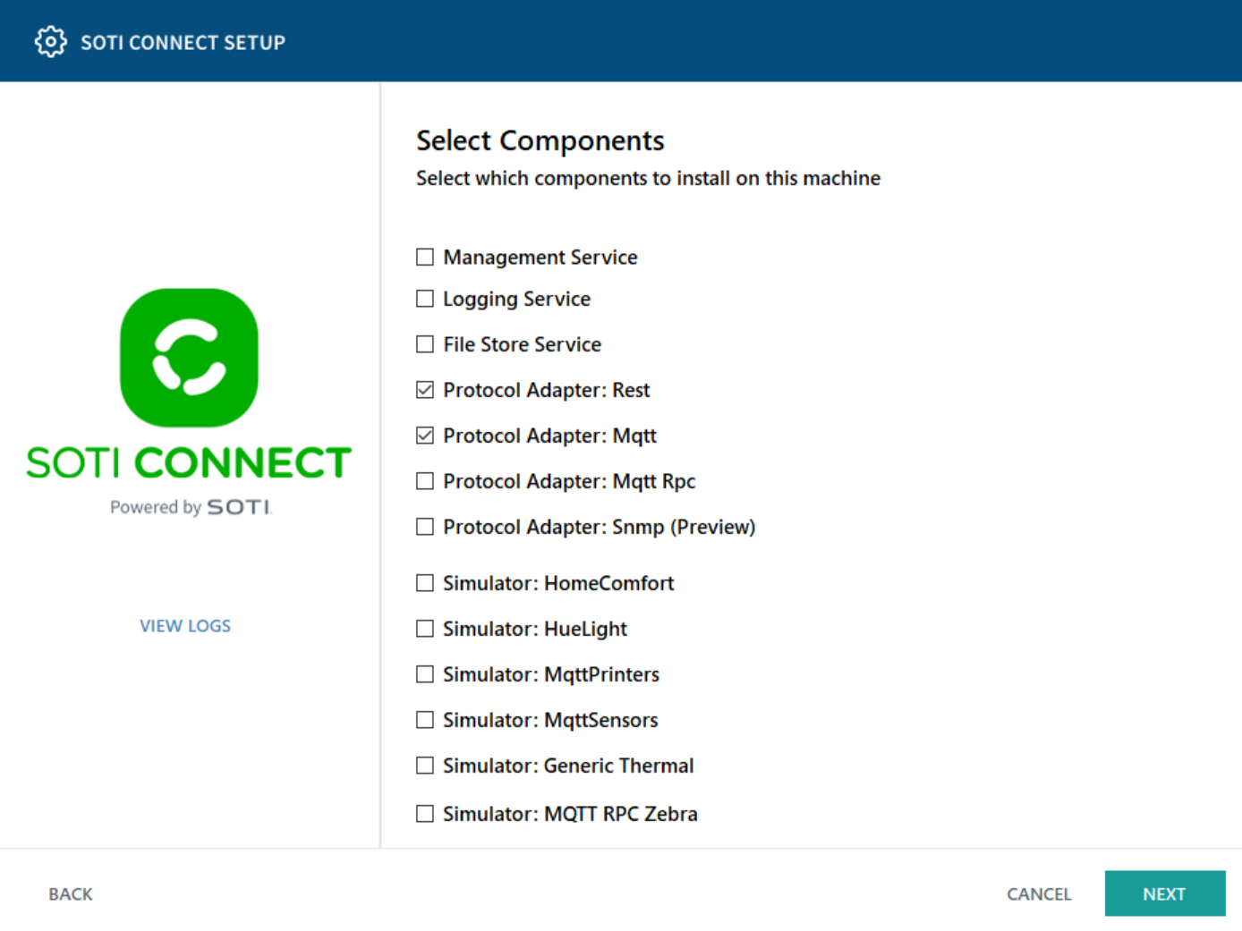

- Run SOTI Connect Installer.exe. The SOTI Connect Setup Wizard is displayed. When prompted, confirm that you want to allow the installer to make changes to your system.
Select Install Connect components and select
Next.
On the Select Components panel, select only the protocol
adapter types you want to install: REST, MQTT, or both.
Make sure all the other components are deselected, then select
Next. The environment is configured as follows.
Verify that the new PAs are running on the screen.
