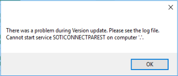

Services Fail to Start During Installation
The system encounters a "Cannot start service" error during SOTI Connect installation, and the SOTI Connect service does not start.
SOTI Connect service not started
Resolution
  1. Stop any running antivirus programs.
  2. Re-run the SOTI Connect installer.

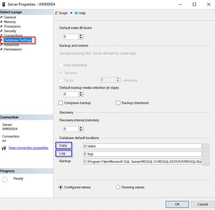

Resolution
Manually delete the SQL data and log files.
  1. Navigate to the Server Properties panel of the VM hosting the SQL, then select Database Settings.
  2. Record the location of the Data and Logs.
    The Database Settings tab shows the location of data and log files
  3. Navigate to the Data and Log directories and delete all files inside.
    Note: Delete only the files, not the directories themselves.

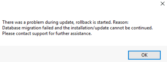

Database Migration Failure: 2024.0 to 2024.1.0.7405
Upgrading from SOTI Connect 2024.0 to 2024.1.0.7405 may fail during database migration and trigger a rollback.

  • Affected versions: SOTI Connect 2024.0 and later
Resolution
Before updating, run the following SQL script to prepare the SOTI Connect database:

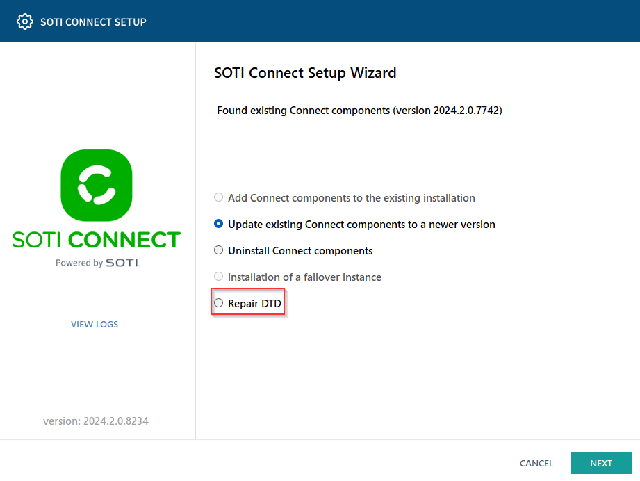

DTD Repair Failure During SOTI Connect Upgrade
Device Type Definition (DTD) Repair is utilized when SOTI Connect changes the semantic ID of a property for a device. During any update, the installer automatically runs DTD Repair with a timeout of 5 minutes. If the repair process is not completed within this time-frame, an explicit warning message displays in the installer UI indicating that DTD Repair has failed.
Resolution
Run the Repair DTD option from the SOTI Connect installer manually, as it does not time out.
  1. Run the SOTI Connect installer as an administrator.
  2. Press CTRL + Double-click on the installer window to reveal the Repair DTD option.
    Repair DTD option
  3. Choose Repair DTD and follow the installer instructions.
Important: Users must run Repair DTD using the installer corresponding to their current version of SOTI Connect (the installer which received the error) before updating to a new version. Otherwise, Repair DTD does not execute during the upgrade process.

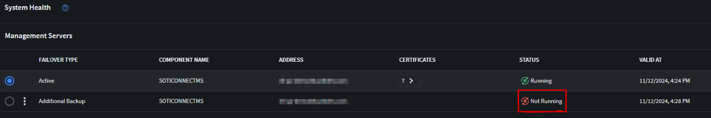

Failover Management Service (MS) Does Not Start After Deploying a Root Certificate
After deploying a new root certificate, the failover MS does not start.
Management Server Not Running
Cause
The failover instance is unable to use the updated root certificate.
Resolution
Note: You must have the root certificate handy.
Manually update the root certificate of the failover instance using the SOTI Connect installer.
  1. Launch the SOTI Connect installer as an administrator.
  2. Navigate to the SOTI Connect Root Certificate view.
  3. Select Import Root Certificate From File.
    Generating a new certificate
  4. Select Browse, locate the root certificate file, and enter the Certificate Password.
  5. Select Next, then follow the remaining steps in the installer to complete the update.
The updated root certificate is applied, and the Failover Management Service (MS) starts successfully.
