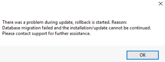

During installation database data deletion step fails and a rollback error occurs
- Symptoms:
- During installation, selecting the database data deletion checkbox at the SQL connection step does not delete data and leads to a rollback error upon installation.
- The following entries appear in the installer
logs:
2023-07-25 17:48:59,992 [ERROR] [ 8] Installer - Database migration failed and the installation/update cannot be continued. Please contact support for further assistance.
2023-07-25 17:48:59,992 [ERROR] [ 8] Installer - Installation failed
System.Exception: Database migration failed and the installation/update cannot be continued. Please contact support for further assistance.
- Troubleshooting Steps:
- Manually delete the SQL data and log files.
- Navigate to the Server Properties panel of the VM hosting SQL and select DatabaseSettings (red box).
- Note the location of the data and the logs (blue
boxes).
- Navigate to the data and log directories and delete all
files in those directories.Note: Delete only the contents of the data and log folders but do not delete the data and log folders.
