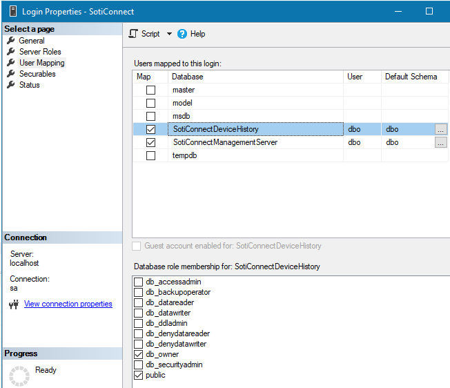

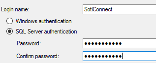

Go to
and create a new login named SotiConnect.

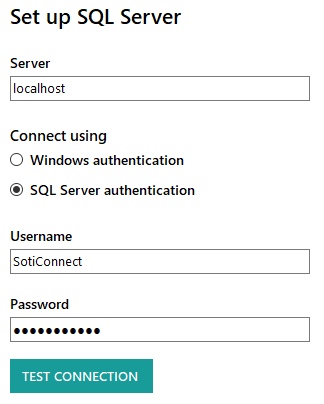

This login can be used during installation of SOTI Connect when using SQL Server authentication.

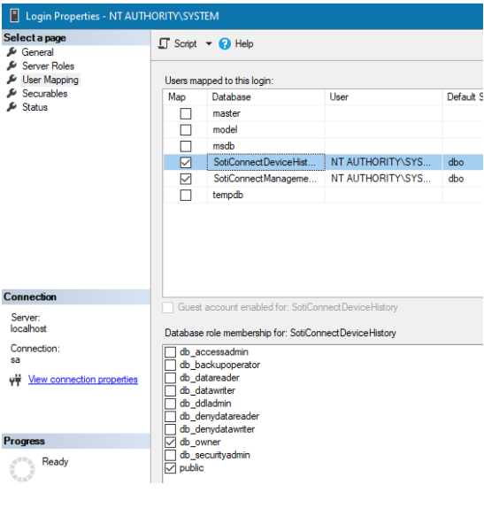

NT AUTHORITY\SYSTEM

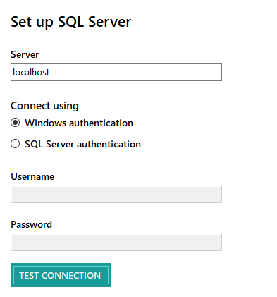

exists. Create it if necessary, and give it the sysadmin server role. and make sure a login namedThis login will be used if SOTI Connect is installed using Windows authentication.
Note that the current user running the SOTI Connect installer must also have the sysadmin role within SQL Server if Windows authentication is being used for the SQL Server connection.

If you used the SQL Server authentication option (that is, using the SotiConnect login in the example above), then you can remove the sysadmin role after installation of SOTI Connect is complete. You should also confirm that the SotiConnect login has db_owner user mappings for all the SOTI Connect databases.
You will need to restore the sysadmin role to the SotiConnect user before running the SOTI Connect installer again.
If you used the Windows authentication method to install SOTI Connect, you can now remove the sysadmin role from the NT AUTHORITY/SYSTEM login. You should also confirm that this login has db_owner user mappings for all of the SotiConnect databases.
You can also remove the sysadmin role from the user who ran the SOTI Connect installer. You will need to restore the sysadmin role to that user before running the SOTI Connect installer again.
