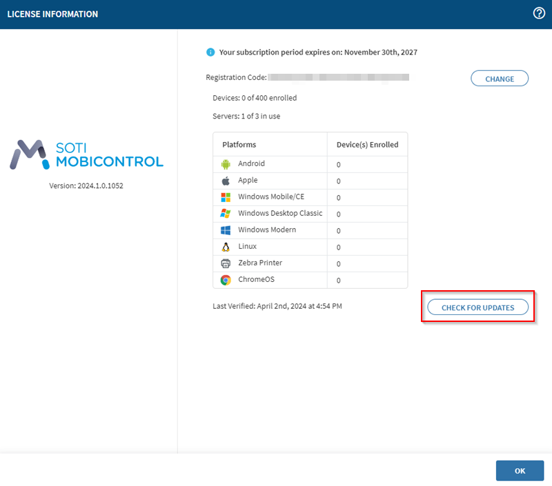

SOTI MobiControl 2024.0.0 and Later
The SOTI MobiControl License Information screen displays the types and quantities of licenses you have acquired for SOTI MobiControl. If the data has changed since the Last Verified date, select Check for Updates (red box below) to update the displayed license information.
The SOTI MobiControl 2024.0.0 License Information screen
