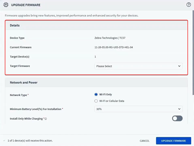

  1. On the console, find the required device or device group and select Upgrade Firmware from the Device Actions menu. The Upgrade Firmware dialog box appears.
    The dialog box lists the selected devices grouped by their device model and current firmware version.
Details
The Details section in the Upgrade Firmware action dialog box.
  1. From the Target Firmware drop-down list, select the required firmware version for each of the device groups.
    Tip: For devices running Android 13 or earlier, select Latest Any to deploy the latest available firmware to your target devices.

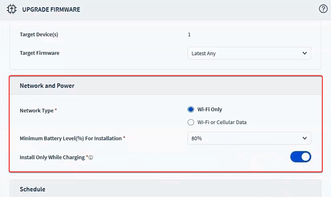

Network and Power
The Network and Power section in the Upgrade Firmware action dialog box.
  1. Decide on the Network Type for the upgrade:
    • Wi-Fi Only: To perform the upgrade only over Wi-Fi.
    • Wi-Fi or Cellular Data: To perform the upgrade over both Wi-Fi and cellular data based on availability.
  2. Select the required battery level for the upgrade from the Minimum Battery Level(%) For Installation drop-down menu.
    Important: Upgrades might fail if the minimum battery level is below 30%.
  3. Enable the Install Only While Charging toggle to ensure upgrades occur only when the device is plugged in and charging.

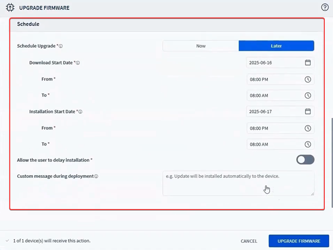

Schedule
The Schedule section in the Upgrade Firmware action dialog box.
  1. Choose from one of the following Schedule Upgrade options:
    • Select Now to perform the upgrade immediately.
    • Select Later to schedule the upgrade for a later time. For this option, set the following parameters:
      • Download Start Date: Choose the date to start downloading the firmware upgrade to the selected devices.
        • From: Choose the starting time for the window during which the upgrade file downloads on the device.
        • To: Choose the ending time for the window during which the upgrade file downloads on the device.
      • Installation Start Date: Choose the date to start installing the firmware upgrade on selected devices
        • From: Choose the starting time for the window during which the downloaded upgrade file installs on the device.
        • To: Choose the ending time for the window during which the downloaded upgrade file installs on the device.
    Note: If a device has already downloaded the desired firmware but is offline during the scheduled installation window, it will continue attempting the upgrade during that window for up to 28 days. For example, if the device comes online during the window on day 14, the firmware installs.
  2. Enable Allow the user to delay installation and specify a duration for which users can delay their scheduled upgrade.
    Important: Postponing installation is not possible when toggling on the Install Only While Charging option.
  3. Enter a custom message for the device user in the Custom message during deployment field. This message appears during the upgrade.
  4. Select Upgrade Firmware to start the firmware upgrade.
