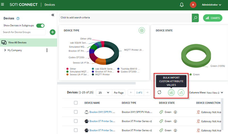

- From the SOTI Connect web console, select .
                Select the Import  icon.
                In the Bulk Import Custom Attribute Values panel, select
