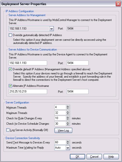

  1. Device Connection Sensitivity
    (Right-click on the Deployment Server in the Deployment Servers view (tab) and select Deployment Server Properties). You can set the Send Test Message to Devices parameter to a higher interval to reduce the communication between the device and the server. This will increase the time it takes for the server to recognize a device as online or offline.

G7. How do I setup my devices to connect through an external network?
When your devices are connected on an external network (GPRS/CDMA) they require a Public IP in order to communicate with your Deployment Server. In most situations companies have a corporate firewall on their Public IP address. You must configure your corporate firewall to allow devices to connect to the Deployment Server. Set up your firewall to port forward from Port 5494 publicly to Port 5494 internally. Port 5494 is used for Windows and Android device communication and is fully customisable by opening the MobiControl Manager, and going to the Deployment Server tab, right click on your deployment server, and select server properties.In the server properties window, you will be able to set a custom port for device communication as well as the public IP addresses the devices must use.
For example, if your Deployment Server has an Internal IP of 192.168.1.184 and your Public IP is 210.25.10.219 all incoming traffic on 210.25.10.219:5494 must be forwarded to 192.168.1.184:5494.
Open the MobiControl Manager, go to the Deployment Server Tab, Right Click on your Deployment Server and select Server Properties. In the Server Properties dialogue box place a check mark in the "Override Default IP" box, and the "Alternate IP Address" box. Enter the Public IP Address or Hostname in the Alternate IP Address box. When finished entering the new information, click on OK. The devices will receive this information upon a device update schedule or as they come online. This change instructs the device to attempt connecting to the deployment server using the Alternate IP Address/Hostname if it fails to connect at the IP Address originally provided. These settings get stored in the device agent and will take effect from now on. Each device MUST connect to the deployment server for these settings to get updated on the device.

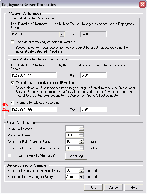

IU4. How do I move my Deployment Server from one machine or server to another?
You need to ensure that the Device Agents installed on the devices are updated with this information before you move the Deployment Server. To do this, add the IP address of the new Deployment Server as the Secondary External IP Address in the Deployment Server properties, while keeping the address of the old Deployment Server as the primary external IP address. Allow the settings to be propagated to the devices. Typically, these settings would be refreshed when a device disconnects and reconnects to the Deployment Server. Once all the devices have the new settings, disable the old Deployment Server (right-click on the Deployment Server and select Disable or Shutdown). Now, when you enable the new Deployment Server on the new server, the devices would be able to connect to the new Deployment Server (after they fail to connect to the old Deployment Server). After all your devices have connected, you can specify the IP of the new Deployment Server as the primary external.
If you are moving from your test server to a production server, we recommend that you create a brand new database:
  1. Run the MobiControl installation file and install the new database on the new computer.
  2. Launch MobiControl Manager when it is done.
  3. Open the Tools menu and click Options.
  4. Click the Connection button.
  5. Change the appropriate settings in this window to point to the new server.

C1. I created an add device rule, generated a Device Agent, and installed it onto my mobile device. Why doesn't it seem to connect to MobiControl?
The most common reason why a MobiControl Device Agent cannot connect to a MobiControl Deployment Server is because there is a firewall between the device and the Deployment Server that is blocking the connection attempt from the device. By default, MobiControl Device Agents open TCP/IP connections to Deployment Servers on port 5494. If this port is being blocked by an intermediate firewall—personal or corporate firewall—then the device will not be able to connect to the server.
A personal firewall is one that on the computer that is running the Deployment Server. For example, the Windows XP firewall (typically running by default) blocks several TCP/IP ports including port 5494. If you are running a Windows XP or other firewall on a computer that is running a MobiControl Deployment Server, make sure that TCP/IP port 5494 is not being blocked.
If your devices are external from your corporate network and need to go through a corporate firewall to get to MobiControl Deployment Server(s), you will probably need to configure external IP address(es) for Deployment Server(s) and then set up firewall rules to map the connections from devices to internal Deployment Server IP addresses. The following steps describe how to configure external IP addresses for your Deployment Servers:
  1. In MobiControl Manager, go to the Deployment Servers view (tab), right-click on the Deployment Server icon for a particular server, and select Properties.
  2. In the Deployment Server Properties dialog box, enter the external IP address and port and click OK.
If you have multiple Deployment Servers, you need to configure a different external address for each server. Once you have configured external addresses, you need to generate new MobiControl Device Agents and install them on your mobile devices. The Device Agents will now use the external addresses to connect to Deployment Servers. To be able to establish remote control sessions to external mobile devices or devices whose IP addresses are not public, you need to set the MobiControl remote control profile for your devices to TCP/IP (SERVER). (The default remote control connection profile setting is just TCP(IP).) You can set the default remote control connection profile when creating device configuration rules or by right-clicking on a device group or device in the MobiControl Manager device tree and selecting the Configure Device(s) menu option.
Note:
MobiControl Deployment Servers always listen for connections on TCP/IP port 5494; this "internal" port is currently fixed. The Deployment Server properties dialog box in MobiControl Manager allows you to change both the external IP address and the external port for Deployment Servers. If you do assign external IP addresses and ports for your servers, you must create a firewall/proxy server rule to map the external address to the internal IP address and port (5494) of your Deployment Server computers.
Example:
If you have configured a Deployment Server as follows:
Deployment Server External IP:Port = 209.151.100.111:2000
Deployment Server Internal IP:Port = 192.168.1.11:5494
You will need to configure a firewall rule to map the external TCP/IP address 209.151.100.111:2000 to the internal TCP/IP address 192.168.1.11:5494 of the Deployment Server computer.

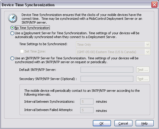

A2. How can I make sure that the clocks on my mobile devices have the proper time?
MobiControl supports two forms of time synchronization: Sync Time with MobiControl Deployment Server and Sync with SNTP/NTP Time Server.
Sync Time with MobiControl Deployment Server: When you enable this option, the MobiControl Device Agent will synchronize the device clock with the Deployment Server clock each time it connects to a Deployment Server. To use this option, you must enable the device time synchronization settings for a device (or group of devices). In the device tree, select the device or group, then select Configure Device(s) from the Device menu, and then select Time Synchronization.
Device Time Synchronization Settings
Sync with SNTP/NTP Time Server: This option uses the SNTP/NTP time synchronization protocol to synchronize the clock on your mobile devices with a public or private SNTP/NTP time server. You can configure this option using the MobiControl Manager. The most common problem with this form of time synchronization occurs when there is a personal or corporate firewall between your mobile device(s) and the time server. To correct this problem, please make sure that connections from your mobile device(s) through UDP port 123 are not being blocked by a firewall. Please see the Device Time Synchronization page for more information on this topic.
A3. Why is the MobiControl Device Agent changing the server host name/IP address information that I am configuring on the device?
The Device Agent is not changing the host name/IP address information on its own. It is the MobiControl Deployment Server that is sending what it believes is the correct address information to the device and asking the Device Agent to update its address information.
When a device connects to a server, the server sends the device what it believes to be the addresses of MobiControl Deployment Servers. The MobiControl Device Agent then stores the server address information it receives and overwrites the previously configured address information. In order for changes to the host name/IP information to stay, you need to configure this with MobiControl Manager:
  1. In MobiControl Manager, go to the Deployment Servers view (tab).
  2. Right-click the icon of the Deployment Server whose address information you want to change, and select the Server Properties menu item.
  3. On the Server Properties dialog box, set the host name/IP address information as needed in the Primary or Secondary External IP Address fields.
  4. Click OK to save the changes. MobiControl Deployment Servers will now send the updated information to devices when they connect.

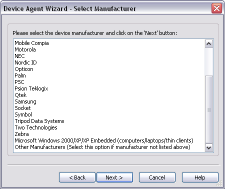

A4. Can I use MobiControl to manage my Windows-based computers, laptops, tablet PCs? If so, how can I create the agent?
You can use MobiControl to manage your laptops, tablet PCs, and even your workstations. You can have the Device Agent installed on these devices and manage them as you would manage your other mobile devices with MobiControl Manager.
You can create the Device Agent using the Device Agent Manager as you would for any other mobile device. When you are creating the Device Agent, select Microsoft Windows 2000/XP/ Embedded (computers/laptops/thin clients)as the device manufacturer.
Microsoft Windows-based Device Agent
Once this is selected, you will notice that you have now skipped some steps in the Device Agent Manager. The next screen will ask you for various software settings.
Follow the remaining steps and once the Device Agent has been created, you are now ready to have it pushed out to your computer, laptop, or tablet PC.

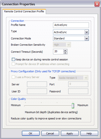

For remotely controlling devices over slow networks, MobiControl provides options to reduce the amount of data that is sent over these networks. A second characteristic of these sorts of connections is that the IP address of the device is often private, meaning that MobiControl remote control desktop software will not be able to initiate a TCP/IP connection to the device. To deal with the private device IP address issue MobiControl has a TCP/IP(SERVER) setting which allows MobiControl to use a connection initiated by the mobile device for remote control purposes.
The following table summarizes the various options available for establishing remote control sessions to mobile devices over slow connections and also devices that have private IP addresses:
Field Name Recommended Setting Description
Type TCP/IP (SERVER) GPRS or dial-up connections often have private addresses for mobile devices connected over these networks. When the addresses for devices are private you need to set the Connection Type field to "TCP/IP(SERVER)" in the remote control profile you are using.
Broken Connection Sensitivity Low This field reflects the responsiveness of the connection. Setting the field to "Low" indicates to the software that the connection is generally slow and to expect lags in waiting for responses. Since GPRS and dial-up connections are generally slow, setting the value of this field to "Low" is usually appropriate. The software will in this case wait extra long periods of time waiting for responses.
Connect Timeout 45 Since GPRS and dial-up connections are generally slow, setting the value of this field to 45 seconds allows extra time for a connection attempt to complete.
Data Compression Advanced Since GPRS and dial-up connections are generally slow, using aggressive data compression will minimize the size of the data thereby minimizing the amount of data sent on slow networks.
Color Reduction 2 bit (4-shade grayscale) Reducing the colors sent in images further reduces the size of the data that needs to be sent on slow networks. You can change the remote control connection settings to view the device display in 16-color grayscale or 4-color grayscale instead of the default full-color display. Although the amount of data transferred will be reduced, CPU usage on the device will increase.
You can edit one of the existing remote control profiles and make the changes listed above or create a new profile. The MobiControl installation software creates a remote control profile called TCP/IP (SERVER) by default. It can be edited.
Once the changes have been made, right-click on the device or device group (if you want to use the profile for a group of devices) in MobiControl Manager and make sure that the remote control profile you just edited is configured for use.
