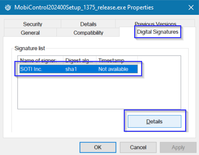

  3. Validate the integrity of the downloaded installer.
    1. Right-click the downloaded installer and select Properties.
    2. Select the Digital Signatures tab, select SOTI Inc. in the Signature list and then select Details.
      Validation step

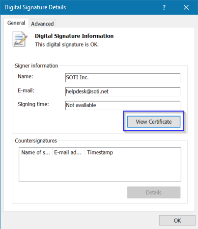

    3. In the Digital Signature Details panel, select View Certificate.
      Validation step

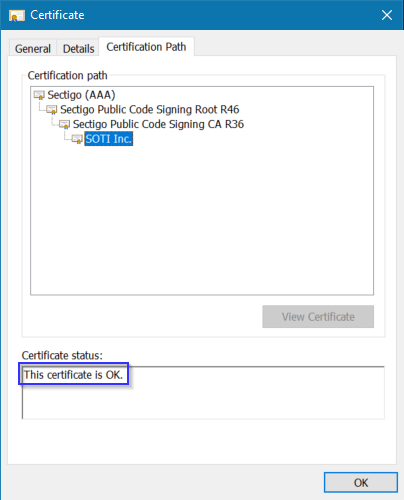

    4. Check that the Certificate status is OK in the Certificate panel.

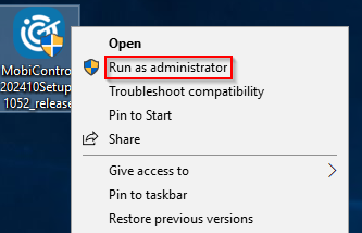

  4. Run the SOTI MobiControl installer as administrator to launch the installation wizard.

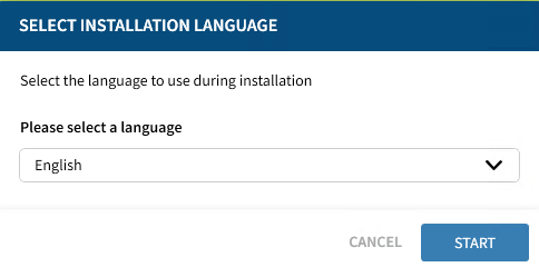

  5. Choose a setup language, then select Start.

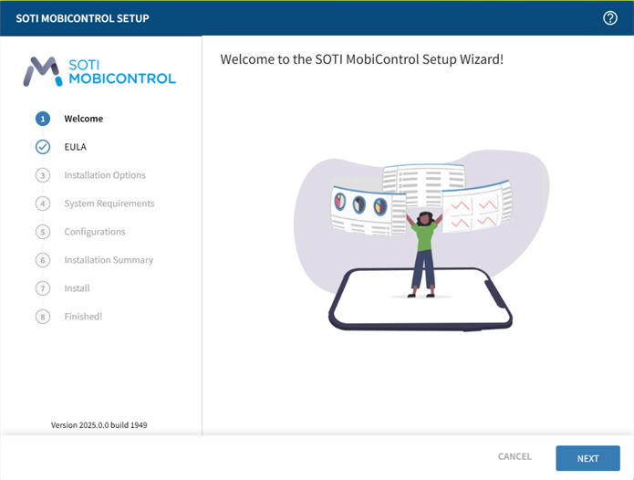

  6. The introductory information displays, then select Next.

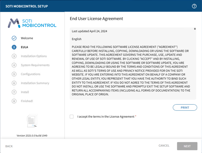

  7. Read and accept the SOTI MobiControl license agreement. You can print the license agreement for future reference. Select Next.

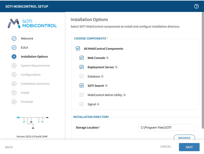

  8. Make sure to select only the Features that you want installed on this server. The SOTI MobiControl installer selects all components by default.
    If the installer does not detect a database on the server, an option to download Microsoft SQL Server 2019 Express displays. If you have an existing database that is not on this server, clear the Microsoft SQL Server 2019 Express option. You connect to the database later.
    Select Browse if you want to change the destination folder from the default C:\Program Files\SOTI\MobiControl. Select Next.
    Tip: SOTI MobiControl 2024.1 and later supports more than one search server. SOTI recommends installing a maximum of 2 to 3 search servers. Deploying more servers may result in increased overhead. In the event the primary search server is inaccessible, the other search servers act as a high availability backup.

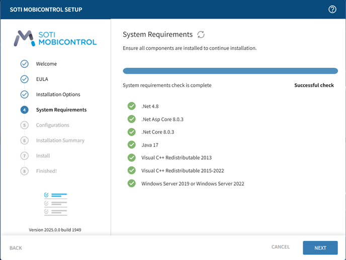

  9. Ensure all components are installed to continue the installation.
    Note: If any prerequisite is missing, the installer gives the option to install the missing requirements

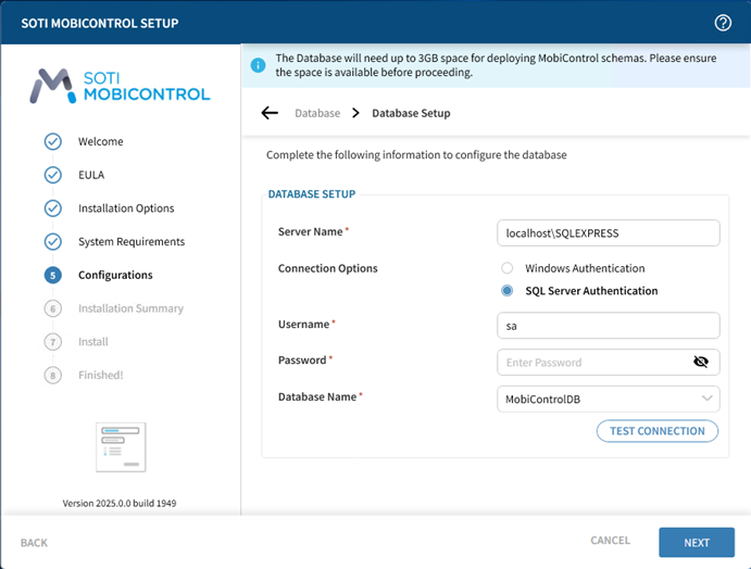

  10. Enter the information to connect to database. Select Next.
    Note: This panel appears only if you opted not to download and install Microsoft SQL Server 2022 Express. See Database Requirements for more information.
    Server Name Use the drop-down to select the location of the database on a computer on the network. You can also type in the network location of the database.
    Note: If you configured your server to listen to a port other than the default (1433), include the port number. For example: SERVER,01234\SQLSERVER .
    Connection Options Select your authentication method:
    • Windows Authentication
    • SQL Server Authentication
    Username Enter the username for the account that SOTI MobiControl used to access the database.
    The account must have read/write permissions.
    Password Enter the password for the account that SOTI MobiControl used to access the database.
    Database Name Enter the name of the database.
    Test Connection Select this button to test your connection to the database.

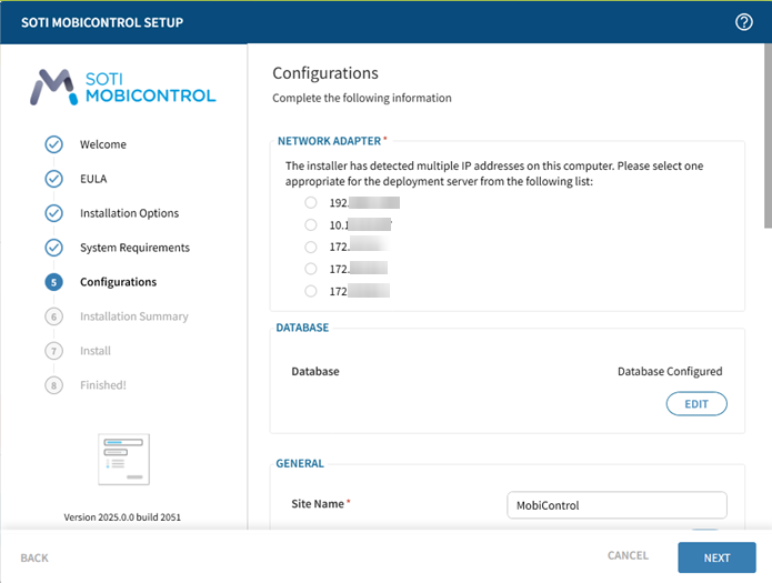

  11. Optional: If the installer detects more than one IP address on the server, you must choose which IP address to use for communications. Select Next.
  12. In the Configurations section, review and fill out the appropriate fields.
    Site Name The automatically configured site name of the SOTI MobiControl deployment.
    Database: Create Backup When enabled, creates a backup of the database. Configure the backup's location on the SQL Server instance.
    Note: This option is only available when performing an upgrade.
    Database: Force Upgrade When enabled, the installer forces the database to upgrade.
    Start Services Automatically When enabled, services start immediately after the installation of SOTI MobiControl.
    Tip: Disable this setting when performing installations or upgrades across many servers since you need to stop services to perform each new installation. Start services after updating all servers.
    Management Service Address The automatically configured address of the SOTI MobiControl Management Service. This address must be in FQDN format.
    Web Console Instance Name Enter a name for your SOTI MobiControl console instance.
    Tip: If left blank, generate the System Root URL based on the Device Management Address.
    HTTPS Port Enter the port number of the HTTPS connection.
    System Root URL Displays the system root URL.
    Certificate Select one of the two options that are available:
    • Generate: Allow setup to generate a new certificate and bind it to port 443.
    • Skip: Skip SSL certificate installation and configure it later with SOTI MobiControl Administration Utility.
    Device Management Address This is the automatically configured address that Android and Apple devices use for connectivity. The address must be in either FQDN or IP format.
    Deployment Server Name Enter a name for your deployment server.
    SOTI Search Address The automatically configured address of the SOTI MobiControl Search Service.
    SOTI Search Port Enter a port number for the connection to the search server.
    SOTI Search Storage Directory Enter the directory where the SOTI Search Server saves its log files and configuration files.

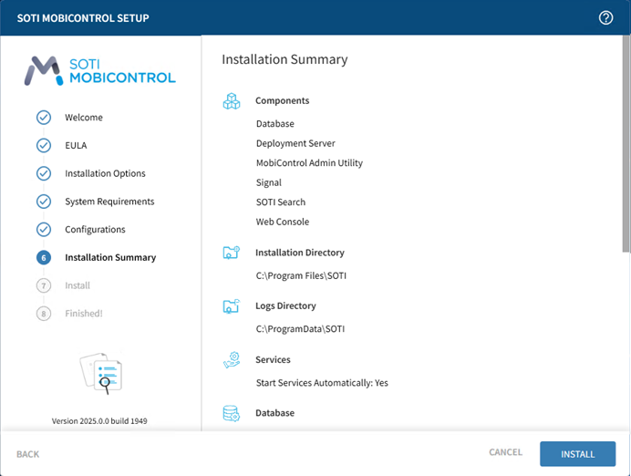

  13. Review your Configuration settings. Select Next to view the installation summary, and Back to return to earlier wizard panels

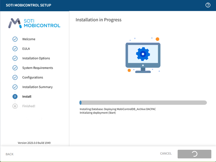

  14. Select Install to start the installation.

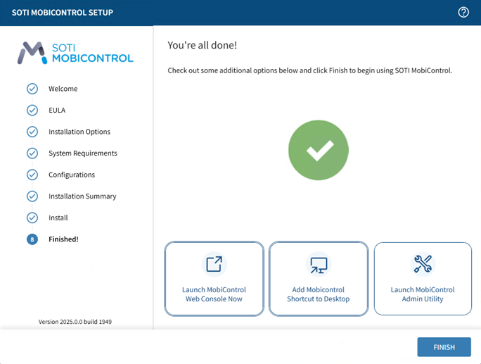

  15. Select Finish to close the installer.
    The installer installs the selected SOTI MobiControl components on the server. You must repeat the installation on all servers with SOTI MobiControl components installed.
