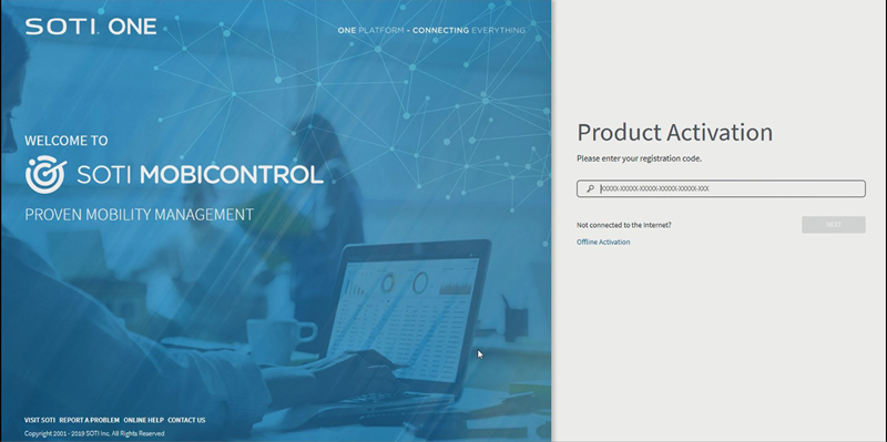

- Launch the SOTI MobiControl console: In a web browser, go to the System Root URL or managementServiceAddress/MobiControl.
On the Product Activation page, enter the registration
code you received from your SOTI representative.
Select Next.

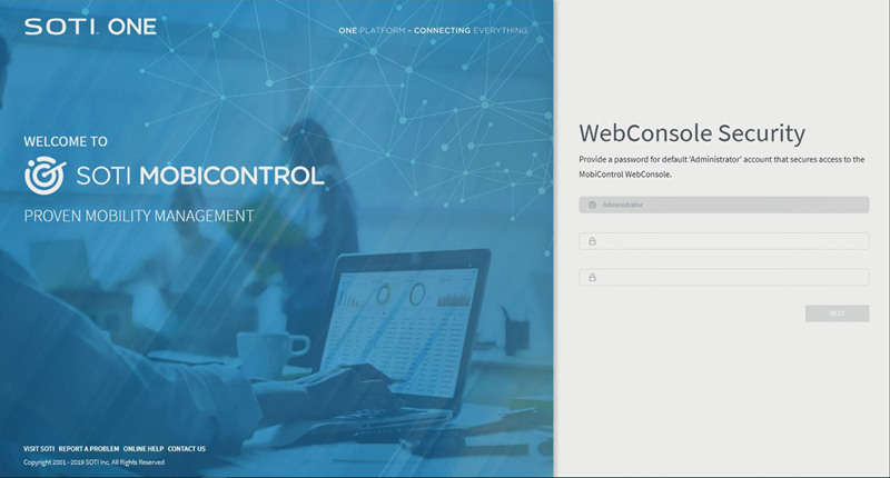

Create a password for the default administrator account for the SOTI MobiControl console. Select Next.
This administrator account has top-level access and permissions, so it is important to choose a strong password and to be careful about sharing it. You have the opportunity to create lower access user accounts later.

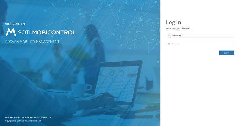

Log in to the SOTI MobiControl console using the credentials you just created.

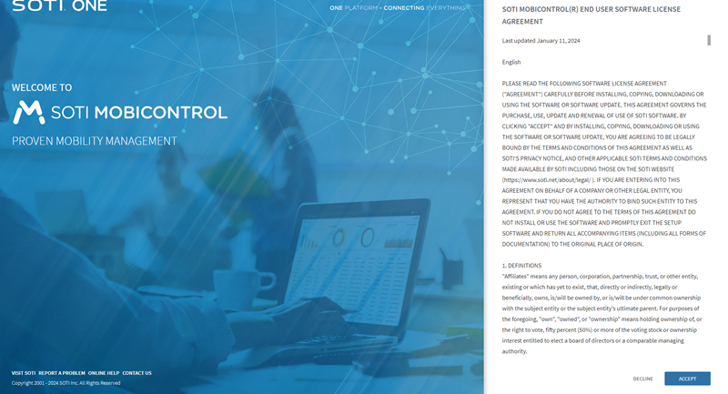

Accept the SOTI MobiControl End User Software License Agreement.
