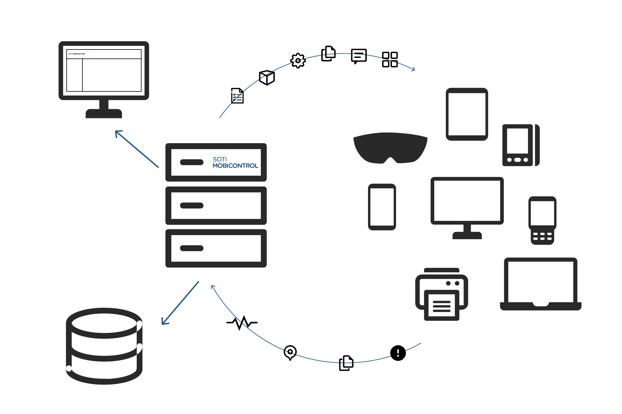

Install SOTI MobiControl to begin managing and monitoring your enterprise mobile devices. Each SOTI MobiControl installation consists of three components.
Component | Purpose |
Database | Stores device information such as status, configurations, and data deployed to the device. If you have a Microsoft SQL Server that meets the requirements, you do not need to install a new version. Otherwise, the SOTI MobiControl installer includes a free Microsoft SQL Server 2016 Express Edition for your use. |
Deployment Server | Relays information -status updates, configuration changes, data points- between enrolled devices and the database. |
Management Service (Console) | Presents an interface for managing your devices. It communicates with the deployment server, exchanging information and pushing commands to devices. |
A basic installation of SOTI MobiControl places all three components on the same server. However, as your device deployment grows, you may need to separate each component onto its own server to maintain the same performance levels. Visit Planning Your SOTI MobiControl Installation to see if you should make adjustments to your server configuration.
