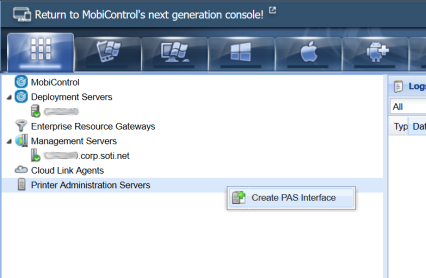

  1. On the server where you want to set up a PAS, open the SOTI MobiControl console. In the legacy console, go to the All Platforms and select the Servers tab.
  2. Right-click Printer Administration Servers in the upper left corner and select Create PAS Interface to open the Create Printer Administration Server (PAS) Interface dialog box.
    Printer Administration Server option on Server tab.
    This will launch the Create Printer Administration Server (PAS) Interface wizard that will take you through setting up a PAS.

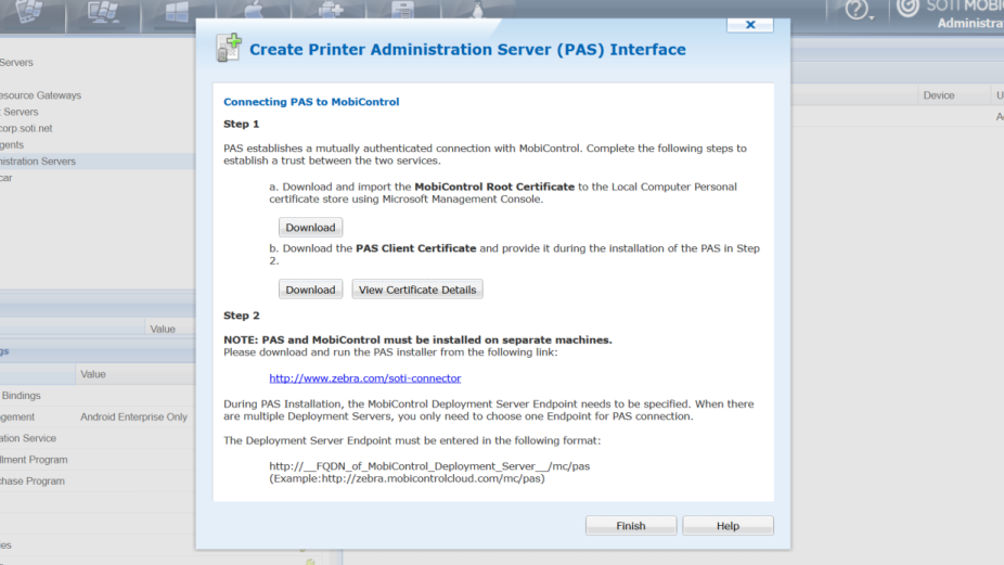

  3. Enter a name for the PAS and click Create.
  4. Download both the SOTI MobiControl Root Certificate and the PAS Client Certificate to your server. You'll need to set a password for the PAS Client Certificate. It is used to generate and export a PAS certificate and bind it to the PAS. The password must be at least six characters.
    Note: Do not close the Create Printer Administration Server (PAS) Interface dialog box.
    Certificate download screen in PAS wizard.

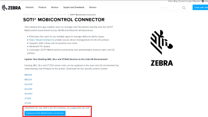

  1. Return to the Create Printer Administration Server (PAS) Interface dialog box, and click the link for the PAS installer or go to the SOTI MobiControl Connector page on the Zebra website.
    Note: On the Zebra website, the PAS is referred to as the SOTI MobiControl Connector.
  2. At the bottom of the page, click the download link for the SOTI MobiControl Connector.
    Location of download link for Zebra SOTI Connector
  3. On the SOTI MobiControl Connector request page, enter the requested information and click Submit.

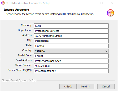

  5. Enter the information requested on the License Agreement and click Next.
    First screen of SOTI MobiControl Connector Setup wizard
    Tip: You may receive errors if your field entries are too long. If this happens, replace the values with meaningless, short values such as 1.

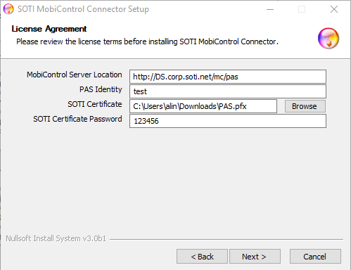

  6. Enter the requested information to associate your SOTI MobiControl server with the SOTI connector.
    Installation wizard screen: connection information for SOTI MobiControl and PAS
    SOTI MobiControl Server Location Enter the location of your SOTI MobiControl server
    Important: Use the fully qualified domain name (FQDN) and add /mc/pas to the end of the server location path. For example, http://example.corp.soti.net/mc/pas.
    Secondly, only use http, do not use https.
    Finally, ensure that the server on which PAS is installed has the outbound ports 80 and 443 open. Unless PAS is on the same server as SOTI MobiControl, in which case, open C:\Program Files (x86)\SOTI MobiControl Connector\tomcat\conf\server.xml and change the port from 443 to another open port. Port 5496 is usually open.
    PAS Identity Enter the name you chose for the PAS in the SOTI MobiControl console.
    PAS name in SOTI MobiControl console.
    SOTI Certificate Click Browse to browse to the location of the PAS client certificate that you downloaded in step 4.
    SOTI Certificate Password Enter the password you created for the PAS client certificate in step 4.
    Click Next.
