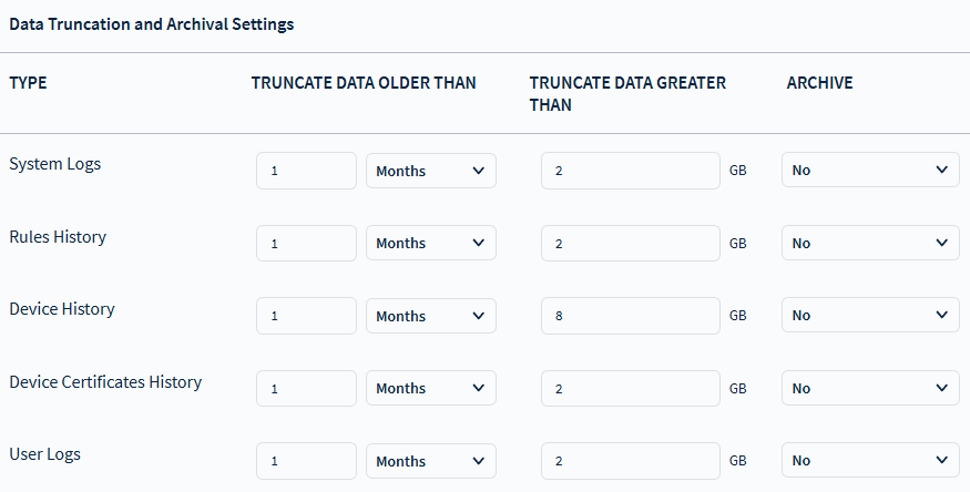

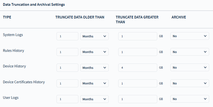

Data Truncation and Archival Settings Recommendation
  • For B2MS instance (default) SQL disk size recommended: 16GB
    B2MS archival settings
  • For B4MS (2x default) SQL disk size recommended: 32GB
    B4MS archival settings
  • For distributed instance (4x default) SQL disk size recommended: 126GB
    Distributed instance archival setting
