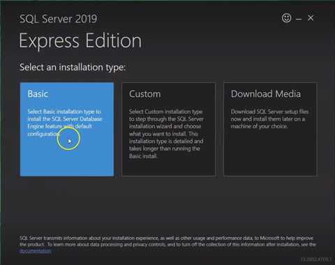

- Run the SQL Server installer .exe file on your local machine.
Select the Basic installation type to download SQL
Server and all related utilities.
