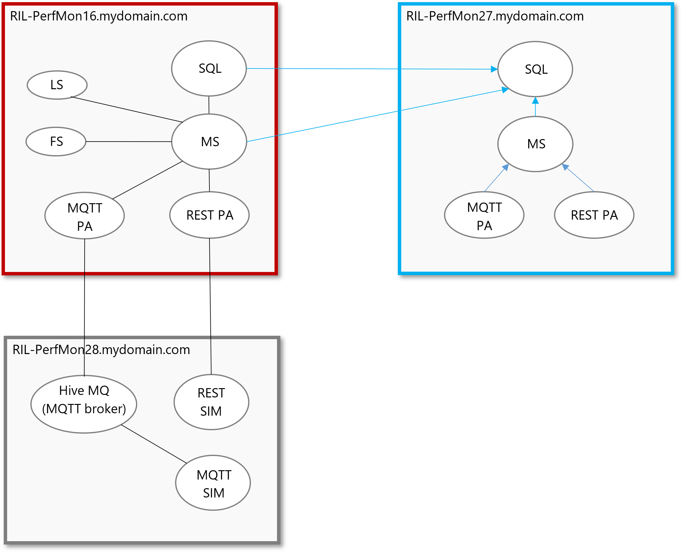

Table 2. Environment
Device System Detail
cluster88.internal.soti.net
  • The system to migrate (source VM)
  • Contains: SQL, MS, LS, FS, REST PA, MQTT PA
db-primary5e.internal.soti.net
  • Destination for the migration (target VM)
  • Contains: migrated SQL
RIL-PerfMon28.sotidev.com
  • Emulates devices
  • Holds the MQTT broker
In our example, the environment should appear as follows:

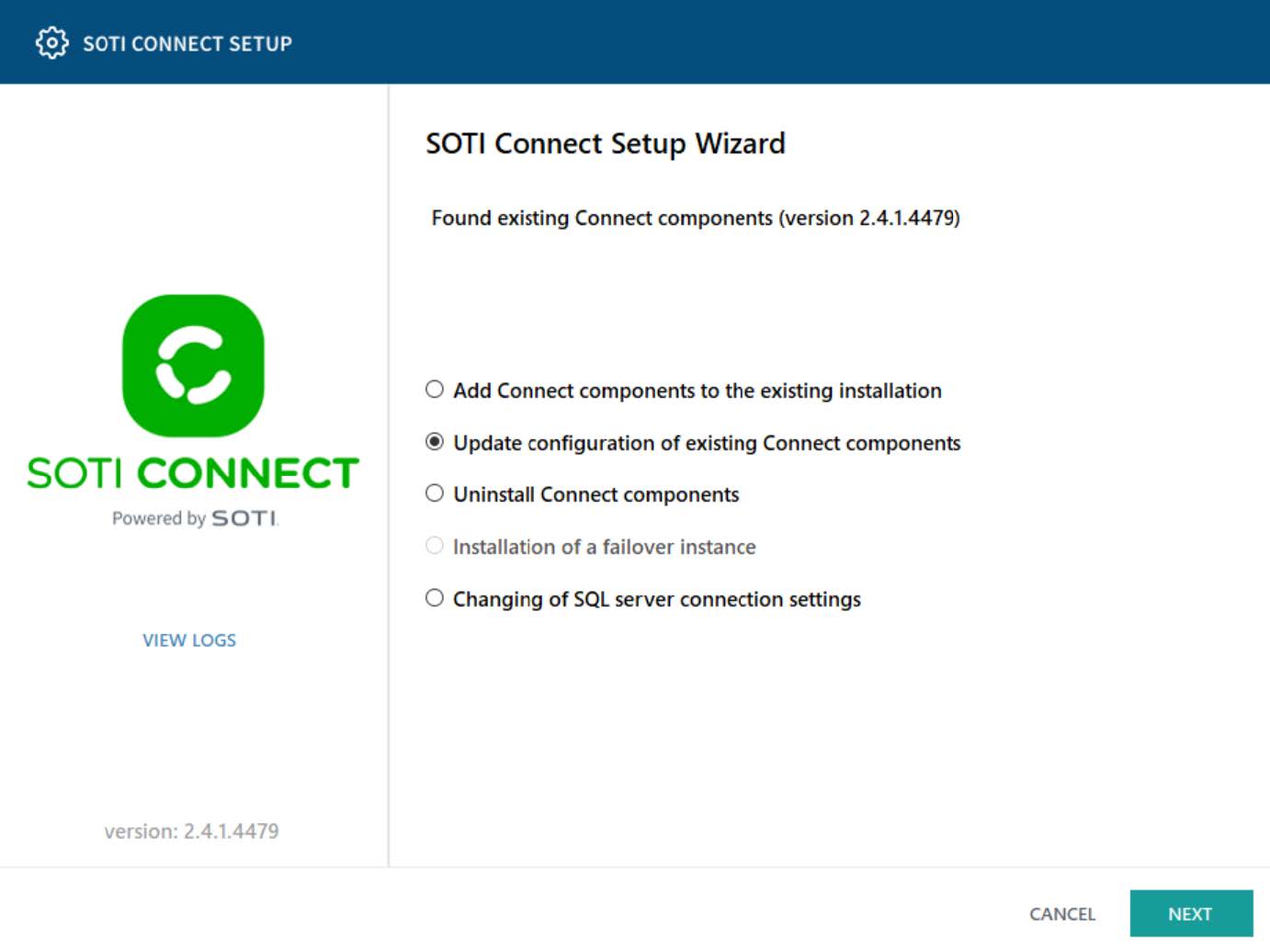

  2. Run SOTI Connect Installer.exe. The SOTI Connect Setup Wizard is displayed. When prompted, confirm that you want to allow the installer to make changes to your system.
  3. Select Update configuration of existing Connect components, then select Next.
    Setup Wizard

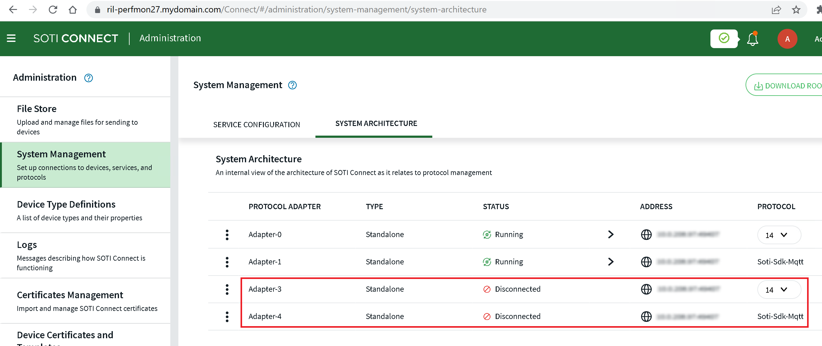

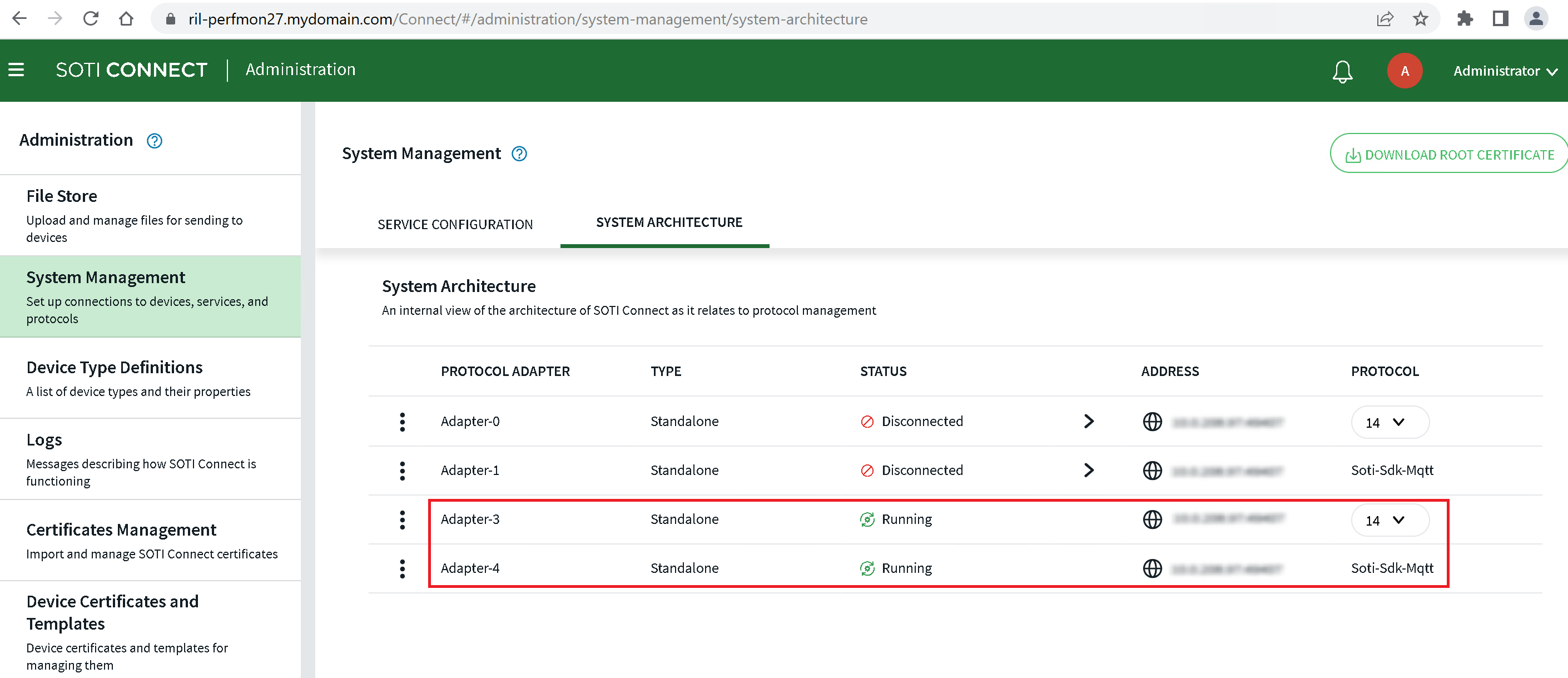

  6. Verify that the new PAs are running on the System Management > System Architecture screen.
    SOTI Connect System Management screen, System Architecture tab showing new PAs

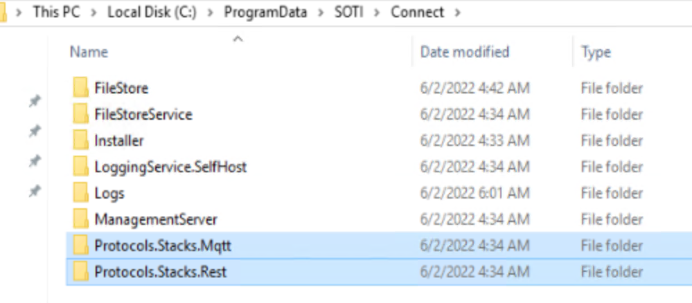

  8. On the source VM, locate the folders containing each PA's ID and copy their .dat files. Folders are named in the following format: C:\ProgramData\SOTI\Connect\[PA type id]\Settings\ComponentIdStore.dat.
    For example:
    C:\ProgramData\SOTI\Connect\Protocols.Stacks.Mqtt\Settings\ComponentIdStore.dat
    C:\ProgramData\SOTI\Connect\Protocols.Stacks.Rest\Settings\ComponentIdStore.dat
    Windows explorer showing showing path to protocol adaptors
  9. Replace the duplicate files on the target VM with the corresponding files from the SRC VM.

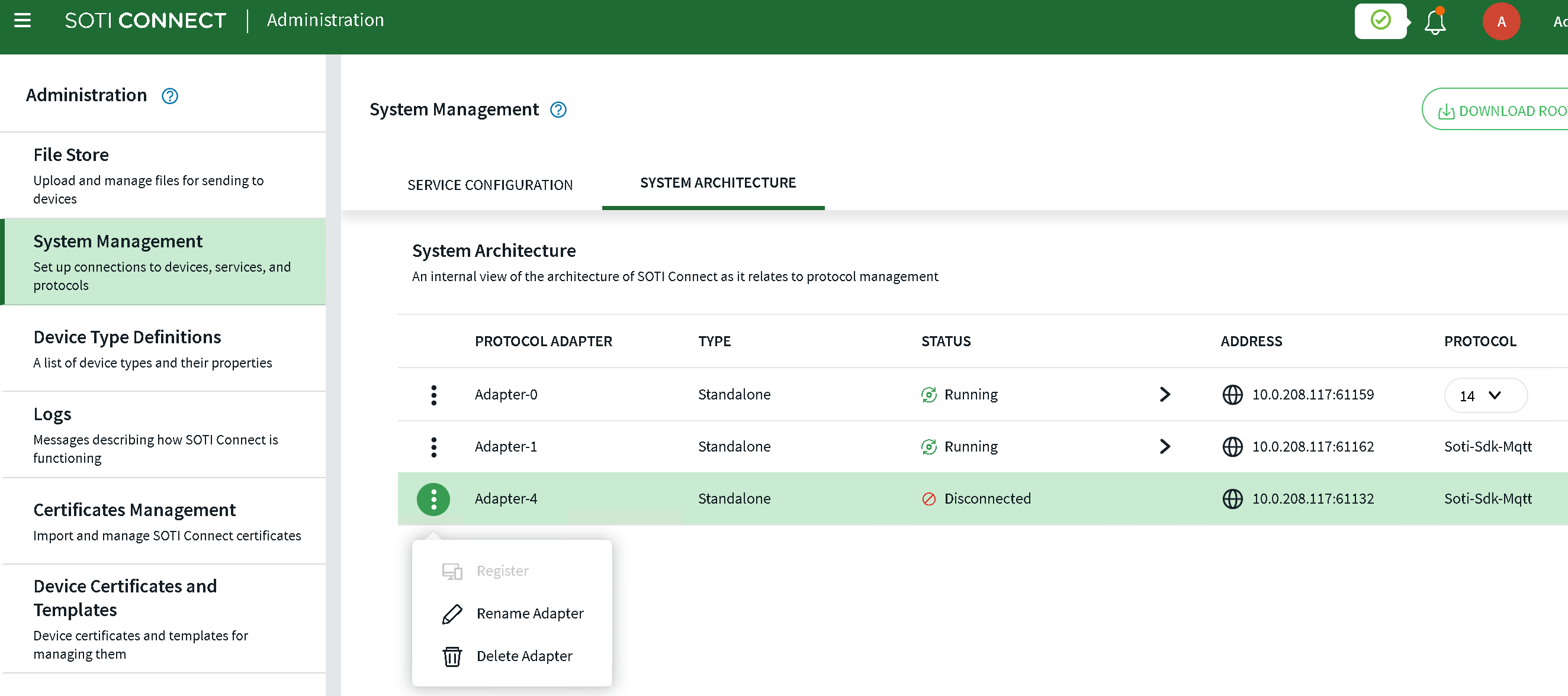

  10. Restart the disconnected services for both PAs on the target VM.
    SOTI Connect Administration panel, System Architecture tab showing stopped PAs

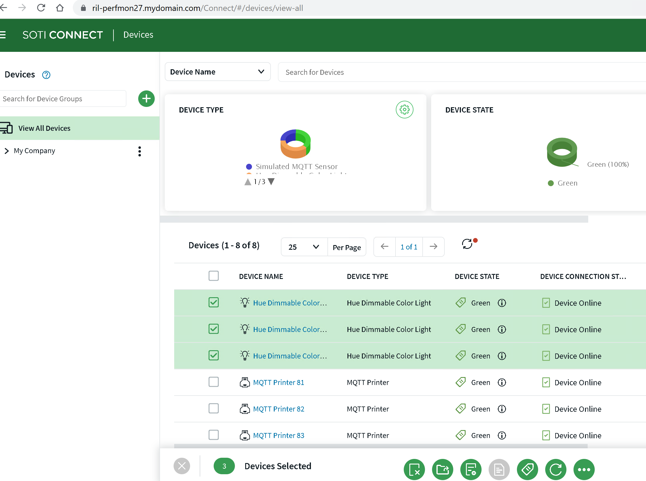

  11. Devices are available once their connection status is updated (up to approximately five minutes). Alternatively, you can manually send any command, such as 'check in', to a device.
    SOTI Connect Devices panel with several devices selected and the Check Action button pressed
  12. Remove any unnecessary PAs.
    SOTI Connect Administration Page with a PA selected and the Delete Adapter option visible

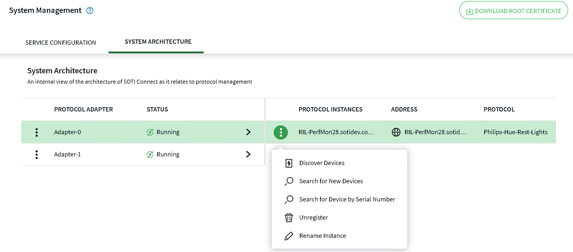

  13. Some devices can send 'push' messages, such as alerts, to a Rest PA. The PA is typically a client which periodically connects to devices. A device can also connect to a Rest PA using a webhook receiver configured during installation. The connection must be refreshed on the device side. To do that, run Discover Devices on the Rest PA as shown in the diagram below.
    SOTI Connect System Management, System Architecture page with PA selected and More options menu open. Discover Devices is shown on the dropdown list
